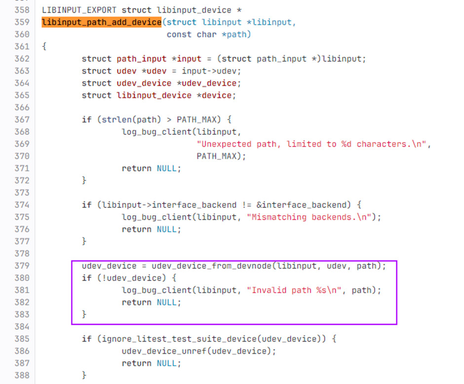

Run the Avalonia .NET application and noticed the following error…

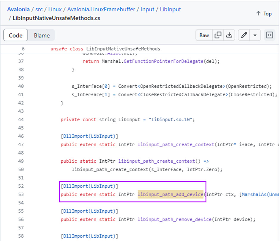

After a bit of researching… traced the reported error to…
GitHub
using System;
using System.Runtime.InteropServices;
namespace Avalonia.LinuxFramebuffer.Input.LibInput
unsafe class LibInputNativeUnsafeMethods
[UnmanagedFunctionPointer(CallingConvention.Cdecl)]
delegate int OpenRestrictedCallbackDelegate(IntPtr path, int flags, IntPtr userData);
delegate void CloseRestrictedCallbackDelegate(int fd, IntPtr userData);
static int OpenRestricted(IntPtr path, int flags, IntPtr userData)
var fd = NativeUnsafeMethods.open(Marshal.PtrToStringAnsi(path) ?? string.Empty, flags, 0);
if (fd == -1)
return -Marshal.GetLastWin32Error();
return fd;
This file has been truncated. show original
Library libinput
File: path-seat.c
Function: libinput_path_add_device

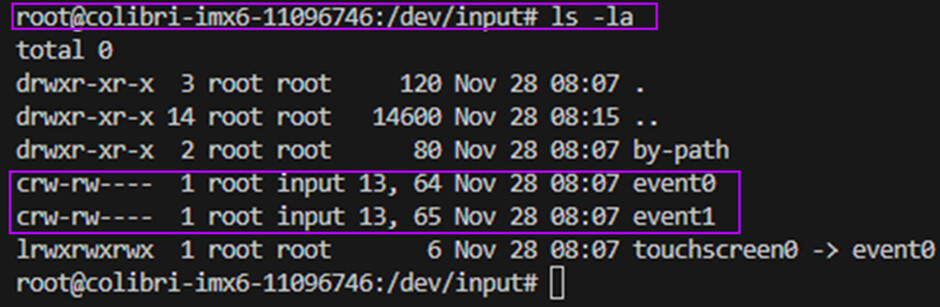

Step 2 - On the board, can you enter the running container with…
$ docker exec -it torizon_avalonia13-debug_1 bash
Step 3
root@colibri-imx6-11096746:/dev/input# ls -la
The ownership seems to be set to the “root” user.
Would this require some permission settings?
Cheers Jon
Hi @jon2023 ,
Thank you for confirming the information.
/dev/input/event* should be owned by root, yes. In fact, all system-related files should be owned by root. Don’t try to change their permissions or ownership as otherwise you may break your OS. I don’t think it’s a permission problem.
