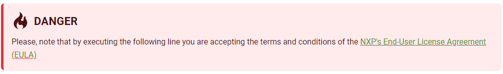

Disclaimer:
docker run -e ACCEPT_FSL_EULA=1 --rm -it --name=qt5 \
           -v /tmp:/tmp \
           -v /dev/dri:/dev/dri -v /dev/galcore:/dev/galcore \
           --device-cgroup-rule='c 199:* rmw' --device-cgroup-rule='c 226:* rmw' \
           torizon/qt5-wayland-examples-vivante:$CT_TAG_QT5_WAYLAND_EXAMPLES_VIVANTE \
           bash
This will launch Qt5 container, that contains Wayland libraries and Qt5 compositor, pre-built Qt5 examples for quick evaluation, and binary drivers for Vivante GPUs (i.MX 8 modules). Please read this reference to read more: List of Container Images for Torizon | Toradex Developer Center.

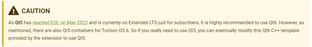

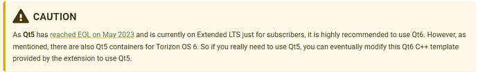

Well, actually just changing 6 to 5 :slight_smile: I would recommend migrating to Qt6 if possible according to this information
