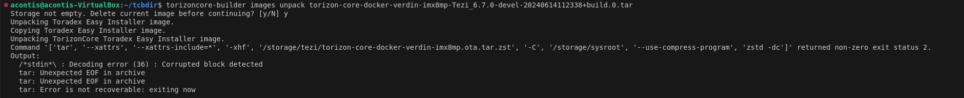

I have already build a Torizon OS from Source With Yocto Project/OpenEmbedded including a acontis layer, so now I would like to use the TroizoncoreBuilder to deploy this customized image on taget device, but when I run the torizoncore-builder images unpack command it fails with the error
Command ‘[‘tar’ , ‘–xattrs’ , ‘–xattrs-include=*’ , ‘-xhf’ , ’ ‘/storage/tezi/torizon-core-docker-verdin-imx8mp.ota.tar.zst’ , ‘-C’ , ‘/storage/sysroot’ , ‘–use-compose-program’ , ‘zstd -dc’]’ returned non-zero exit status 2.
Output:
/stdin\ : Decoding error (36) : Corrupted block detected
tar: Unexpected EOF in archive
tar: Error is not recoverable: exiting now
Any help how to fix this error

Hi @jeremias.tx
Thank you for your reply,
  1. Yes, the isssue is related to unpacking the image that i have build from the yocto project using the TorizonCore Builder images unapck command.
  2. Other than Acontis layer there is no other customization durng the build
  3. Yes the error is the same happend when I run the torizoncore-builder images unpack <image-name.tar>
