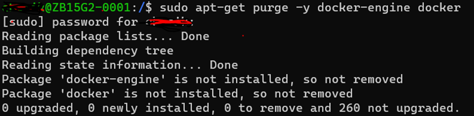

  • What version of Docker Desktop do you have installed on your machine?
  • You only have Docker Desktop installed, correct? You don’t have something strange where you have Docker engine/Docker Desktop also installed in WSL?

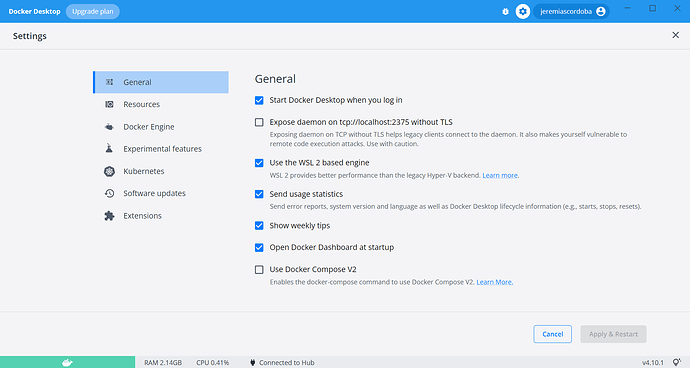

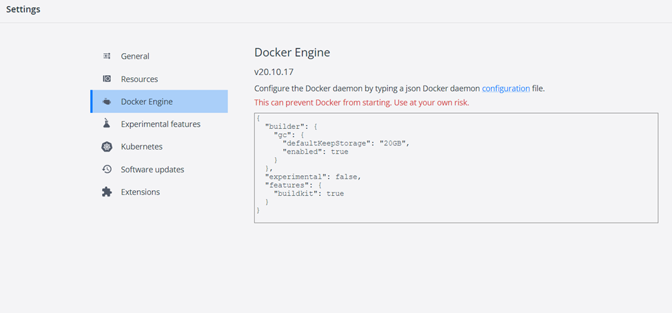

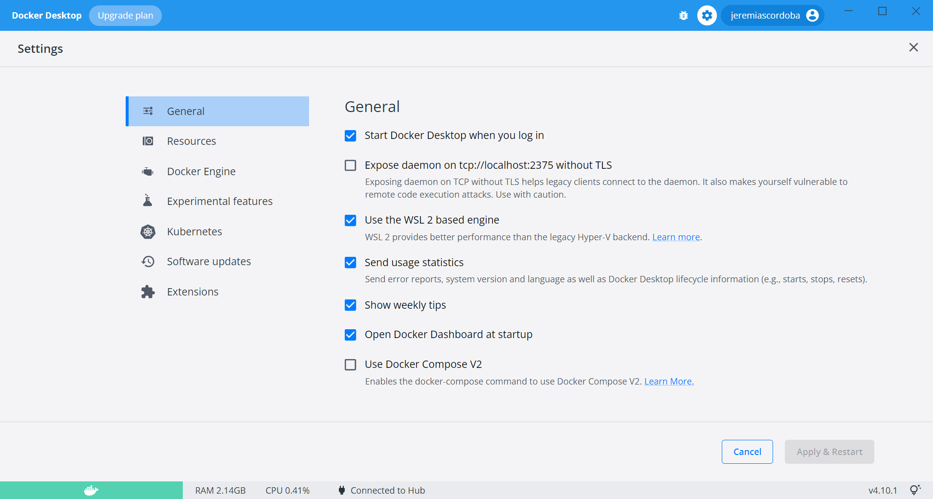

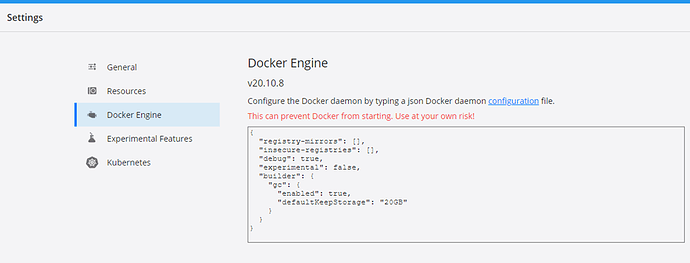

To answer your questions:
On the 1st machine where I receive “Can’t determine current container id” Docker is not installed in WSL as indicated below
The Docker version on the machine where I receive “Can’t determine current container id”. Docker was uninstalled and installed again
Docker settings on PC where I receive “Can’t determine current container id”
Docker settings on machine where I can successfully execute bundle with “Torizoncore-builder build”
I don’t know why the settings in docker engine are different and i don’t know if it makes a difference.
thanks
Huh that’s interesting, so there’s two things that might be the cause here. Either the issue is related to the different Docker Desktop settings. Or it’s related to the different Docker Desktop versions.
Let’s try this. Copy the settings from the machine where bundle worked and transfer these settings to the machine where bundle failed. Most notably I recall in the past we’ve had issues with some machines where buildkit was enabled.
If after having the same settings your first machine still fails to execute bundle the issue might be the Docker Desktop version. But I’m not sure how we’d go about confirming this.
I copied the “Settings - Docker Engine” contents (as shown in earlier reply) from the working machine to the non-working machine and it made no difference. I still receive “Can’t determine current container ID”
