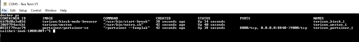

It appears I messed up with my previous attempts. I don’t see a field for confirm password.
Is there a way to reset the passwords for both Portainer and Kiosk-mode browser interface?
I stopped the containers, removed the images and pulled new images but it appears the password is buried some place in the flash drive.
Also, what controls the containers to start automatically on boot? How do I enable/disable containers to run on boot?
Our portainer configuration creates a docker volume with the name portainer_data. This would be my best guess of where this password information is stored persistently. You can remove this volume with the docker volume command.
As for container auto-start. We have a systemd service called docker-compose that auto starts the docker-compose.yml in a pre-determined location. This is what auto-starts Portainer and the related containers. You can just enable/disable this via systemctl.
Just for future reference, I also forgot the portainer password for one of my boards and
torizon@apalis-imx6-11056663:~$ sudo systemctl stop docker-compose
torizon@apalis-imx6-11056663:~$ docker volume rm -f torizon_portainer_data
torizon@apalis-imx6-11056663:~$ sudo reboot
dropped me in the “New Portainer Installation” screen and I was able to create another admin user.
