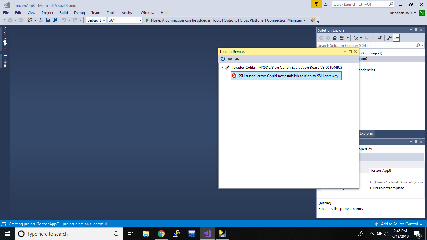

I have followed the toradex webinar to add torizon extension for Visual Studio 2017 and i have added the extension and docker in my host pc. Once when i try to connect my device in vs2017, i am able to see my device but i could not see the process, images or containers and it shows ssh error. I have attached the screenshot of the error. Kindly guide me to add my device with vs2017.

Dear jeremias,
I have got this error by using serial (COM) port only. I also tried with ethernet but the same error exists. Every time once when VS2017 detects my device, my device reboots itself and i am not able to see the processes, images and containers.

Hi @nishanth1829,
That’s odd the picture you posted of the error seems to suggest you’re attempting to connect via ssh. The device rebooting itself is also very odd.

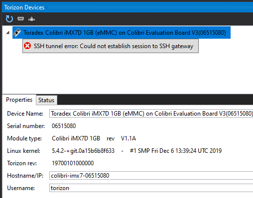

I have the same issue as the original poster. VS2019, Torizon VS Dev Tools 1.0.0, connecting over the serial port. Putty connects with no issue.
So I connected over the network. Same error at first, but a combination of “refresh” and “update” fixed it.

I had the same issues but I found the problem, and its a daft one.
Windows Studio does not forget about SSH connections; it makes duplicates with conflicting parameters, each time you reconnect the devices. Once you have a few duplicates, the SSH error appears and you are stuck.
So the way to fix this easily is to
  1. Type in “SSH” in the Search box, and that gives you an option to add and remove SSH connections. Please select it.
  2. Delete all the offenders. I just normally clear all these away. It seems the extensions make some more if you do a reconnect and rebuild your SDK containers.
  3. Reconnect your device (put the username and password in again) and let the module do a reboot.
  4. Rebuild your build container, and then do whatever you want. I am still coding up so I use the Deploy and Debug to run my code and watch it all go horribly wrong.
Bob’s your uncle, back in business.
It just needs Windows people to add an option to wipe these when you create a new project, and remember not to keep re-registering your Colibri device - just hit refresh.
