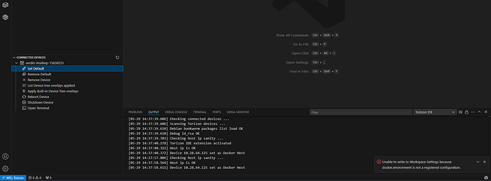

Just got a new verdin SOM and mallow carrier board. New to Toradex’s ecosystem. I’m working through the quickstart guide for developing applications for Torizon. The SOM appears to be connected properly to the Torizon IDE extension, however, the Set Default command for the connected device fails with the following error message:
“Unable to write to Workspace Settings because docker.environment is not a registered configuration.”
settings.json is not updated at all. I’m unsure what/how to troubleshoot this.

Greetings @JeffP,
This appears to be due to a change from Microsoft. They changed how the Docker extension works which our extension relies on. For the time-being you can downgrade the Docker extension to a previous version that works with our extension. This comment on this other thread shows how you can do so: Update fails many times from Torizon clouad - #23 by henrique.tx
Our team does plan to release a new version of our extension soon that works with the change from Microsoft.
