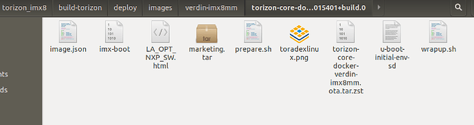

Also I have done what you suggested: Bitbake torizon-core-docker creates an images folder which includes
But there is no file with wic extension only file with tar extension.
How can I deploy “torizon-core-docker-verdin-imx8mm-Tezi_5.6.0-devel-20220312015401+build.0.tar” file to my SD Card ?
