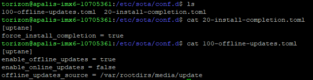

Following this, I need to manually reboot the system for the changes to appear. Since my containers are quite big, I had to modify some settings, as mentioned by @jeremias.tx in the following thread to make it work: Synchronous offline updates broken - #14 by jeremias.tx
See below a screenshot of my Secure Offline Updates config files.

Since the reboot isn’t automated, is that intended during synchronous updates or did my configuration changes break it?
That’s weird the reboot should happen automatically after some time even with the workaround you referenced in that other post. Your changes look okay, are you sure the reboot isn’t happening?
