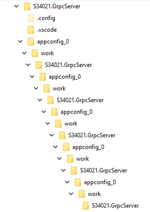

I have a problem with a Torizon project I’m working on. Generally, my build/debug cycle is going fine, but after a while the build fails because a file path name gets too long. What is happening is that the “/appconfig_0/work” folder gets recursively nested. Here is a screen shot of what is happening:
If I delete the nested part of the folder structure, then everything works fine again (until the nesting gets too long again).
What is causing this and how can I prevent it?

The new nested folder is being created every time I start a debug session (F5). If I stop a debug and start it again without making any code changes, another nested folder is created. Just doing a build does not create the folder.

I then had a look at another project I started at the same time as the original one I reported, and it does exhibit this problem. So it seems there is something lingering in the way something was originally created in these older projects (I created them both around the middle of last year using whatever version of the tools was current then).
One thing I noticed is that the existing projects are referencing “dotnet-50_bullseye” whereas the new test one is referencing “dotnet-60_bullseye”. I tried changing the test one back to “50” (by editing torizon-vscode-settings.yaml) but this seemed to make no difference. I do not know what the significance of this setting is (maybe I should ???).

I checked the change that we did in order to fix this issue the first time. It seems we modified the template for .NET projects so that they the following line in the *.csproj
file:
<DefaultItemExcludes>$(DefaultItemExcludes);appconfig_*\**</DefaultItemExcludes>
If this is really the case then it makes sense why your old project still exhibits this bug since it would have been generated before this fix.
From what I understand this was only needed in some .NET projects and not all of them. Basically it will prevent the project from adding itself inside itself. Could you try manually editing your old project’s *.csproj
file to have this line and see if that alleviates the issue?
Great - that has fixed it!
For reference, this line is not included when the “console” template is used, but is included when the Blazor template is used.
