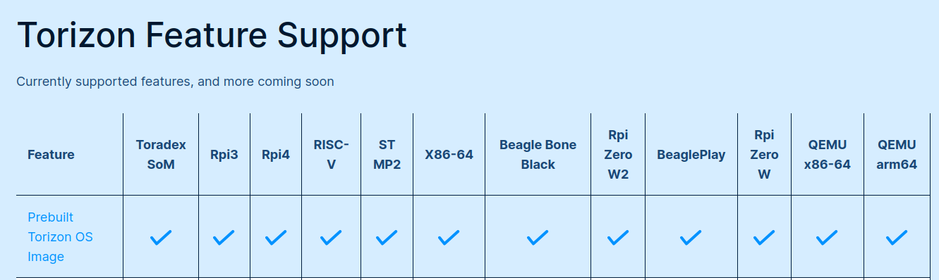

What does the tick next to ‘pre-built Torizon OS images’ here signify then? That someone once managed to build it probably, but it’s not available for download?
Greetings @sam_uk,
Those repositories in the Common Torizon namespace are deprecated. Meaning they’re no longer in active development or even maintenance. All 3rd-party hardware is now being actively maintained in the core meta-toradex-torizon repository here: GitHub - torizon/meta-toradex-torizon: Torizon OS OpenEmbedded Distro Layer
Unfortunately the BeaglePlay has not been ported to this repository at this time. Currently we have no pending plans to do so. The repository is open to contributions if you want to contribute a working configuration for the BeaglePlay.
