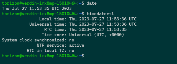

But I see that the timestamp is wrong, and not updated from the web, even if the NTP service is active.
And since the datetime is quite old, when I call
docker compose ... up
and the container is not available locally, the SoM cannot download it because a certificate issue similar to this one
current time 2023-07-27T11:53:36Z is before 2023-10-05T00:00:00Z

This is on 6.4.0 same version as you. Is this behavior reproducible for you? Also can you check the logs of systemd-timesyncd.service. Maybe something went wrong with the time sync service here.
