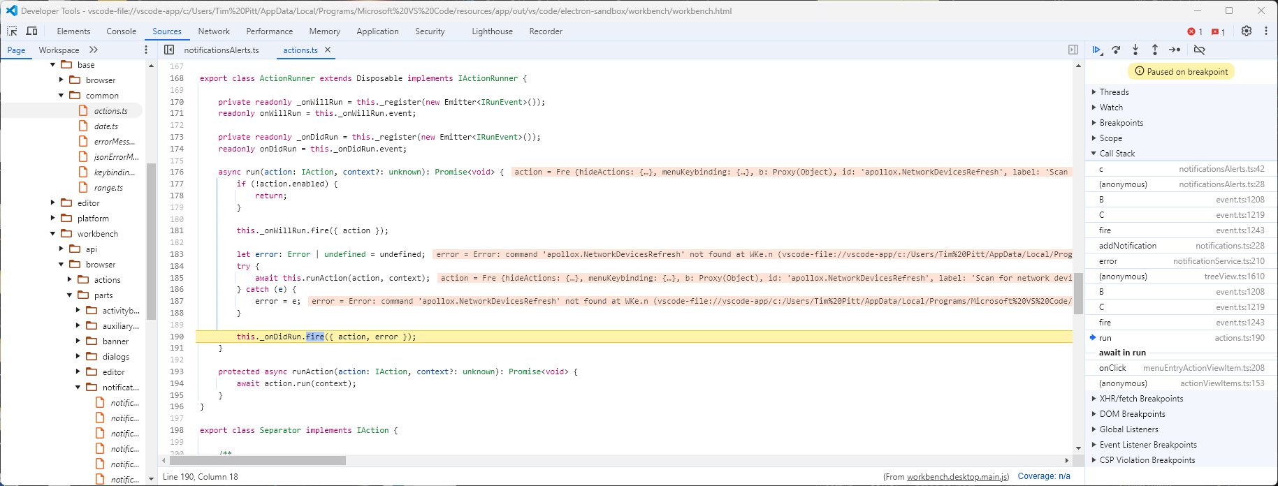

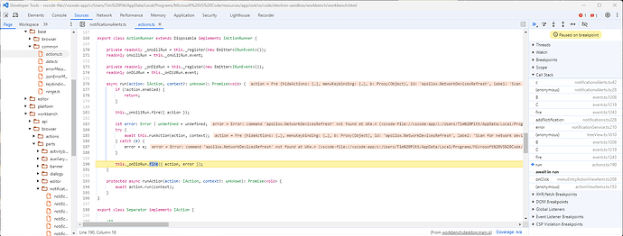

Please reproduce the error again, but with the developer tools activated on VSCode.
To get the developer tools, press F1, type “Developer tools”, and select the option Developer: Toggle Developer Tools. It will open a new window, select the tab Console, and reproduce the error.
With this, you’ll get additional log errors. Please post the log here, so our IDE team can take a look.
The only other clue I can offer is that I’ve only installed VSC/Torizon IDE in the last couple of weeks - thinking that developers/existing users have something set up slightly differently for historic reasons.
So, I re-installed 3.1.0, then restarted VSC, opened the developer tools, and then clicked the button to try to refresh the devices.

notificationsAlerts.ts:42 Error running command apollox.NetworkDevicesRefresh: command 'apollox.NetworkDevicesRefresh' not found. This is likely caused by the extension that contributes apollox.NetworkDevicesRefresh.
c @ notificationsAlerts.ts:42
(anonymous) @ notificationsAlerts.ts:28
B @ event.ts:1219
C @ event.ts:1230
fire @ event.ts:1254
addNotification @ notifications.ts:228
error @ notificationService.ts:189
(anonymous) @ treeView.ts:1610
B @ event.ts:1219
C @ event.ts:1230
run @ actions.ts:190
await in run
onClick @ menuEntryActionViewItem.ts:210
(anonymous) @ actionViewItems.ts:153
