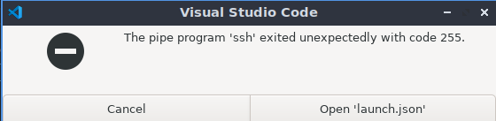

Here’s a more verbose version of the error that I get:
Starting: "ssh" -T -q -p 2225 -i "/media/sf_repos/MyProject/.conf/id_rsa" -o StrictHostKeyChecking=no -o "UserKnownHostsFile /dev/null" torizon@10.130.11.115 "/vsdbg/vsdbg --interpreter=vscode"
The pipe program 'ssh' exited unexpectedly with code 255.

I’ve had a few occasions when I run certain commands (can’t remember which ones) using an SSH client (not through VSCode extension) and I get prompted the password 3 times as well. Therefore, I don’t think it’s a problem with the extension itself, I think there’s been a misconfiguration step somewhere either on the VM or the Toradex and I’m struggling to find it.
I agree with you that something might have been done wrong in the setup and I think it has something to do with id_rsa but I’ve tried many options with no success.
