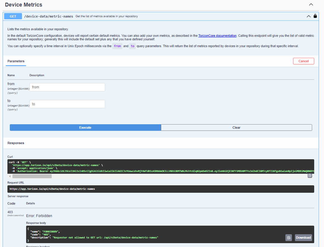

Torizon API returns 403 since today
our test application uses the torizon API
But, It stopped working today!
First I thought the bearer token is outdated, so I created a new one as described here:
1.) new client → Torizon Cloud API (Beta) | Toradex Developer Center
2.) new token → Torizon Cloud API (Beta) | Toradex Developer Center
But still, for the requests related to the device metrics the response is 403
The other endpoints seem to work normal

Hi @dan
Thanks for reporting this issue and sorry for any inconvenience.
We just updated our back-end authentication method and it seems that some client_ids permissions didn’t fully migrated to the new format.
Those steps you mentioned should be working in a few hours.
Ok after recreation of the client it is working now thanx
