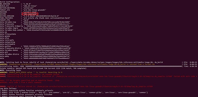

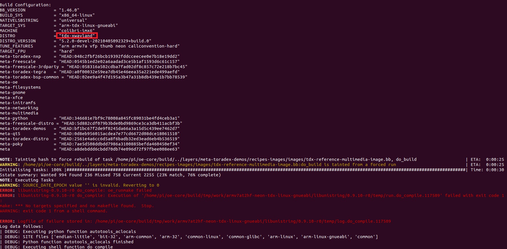

When building “tdx-reference-multimedia-image”. libunistring gives an error and the build cannot continue. The target when imx6 is specified may not be set.

Dear @takehito_yoshida , can you try with the tdx-xwayland (without RT) distro and see if that solves the issue?
Dear @alvaro.tx ,I will try it immediately and report it. {tdx-xwayland (without RT) distro}
Dear @alvaro.tx ,Unfortunately, the result was the same.
