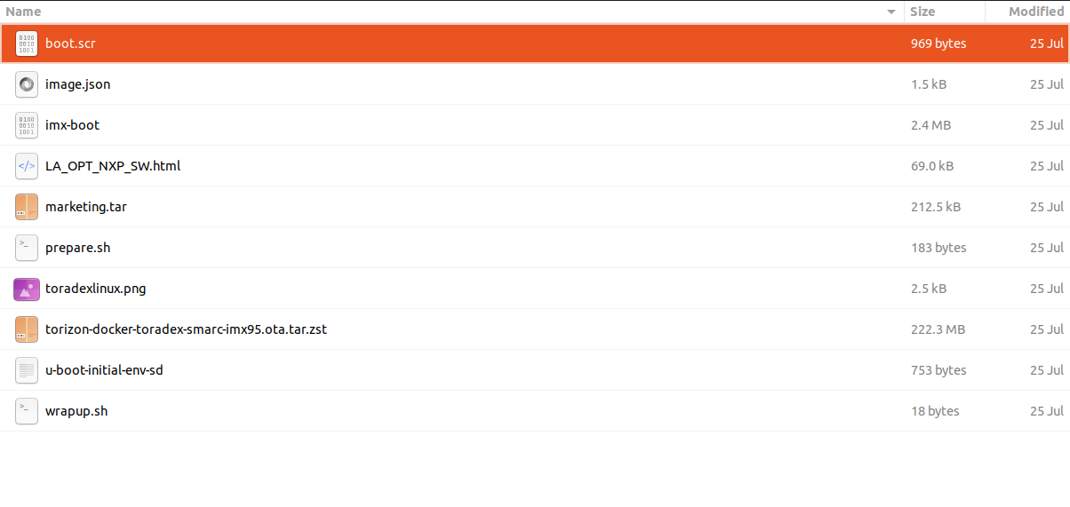

In the below-mentioned picture, there is a build image available on the Toradex website(for SMARC IMX95 -( SMARC iMX95 7.3.0+build.18 2025/07/25 214.61 MiB).
We have downloaded that file, but there is no .wic or any other format to flash in the SD. How to flash the image to the SD card. I will share that extracted directory for your reference. Could you please support this?

HI @Govind1807
This file is to be used with the Toradex Easy Installer.
  1. Copy this folder into the SD card.
  2. Download the Easy Installer
    Download Toradex Easy Installer | Toradex Developer Center
  3. Put the device into recovery mode
    NXP i.MX and TI AM62x Recovery Mode | Toradex Developer Center
  4. In the interface, select the image to be flashed.
You can find the full instructions here.
