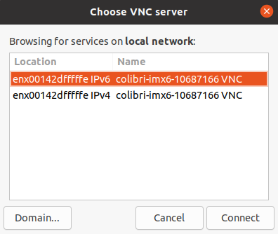

enp4so is the interface/ethernet port from the server that connects to the ethernet slot on the board.
When I do ip a show, enp4so is down and I am unable to bring it up. It has some 169.xyz address. dnsmasq has not assigned an ip from the range specified in the dnsmasq.conf file.
The nginx server is configured correctly according to:

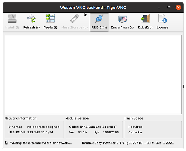

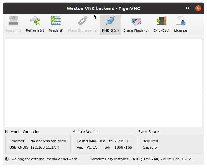

The problem is with dnsmasq. It is not assigning an IP to the interface in /etc/dnsmasq.conf from the dhcp-range. In the VNC you can see that there is no address assigned to Ethernet. Additionally if you look at my entire post, dnsmasq service is giving the error - warning: interface enp4s0 does not currently exist. It’s unable to assign an address from dhcp-range.

Please look at all the screenshots in my original posts.

Could you explain that, please? Here is the current setup: I have one interface on the server that gets the IP from the office DHCP server. I assigned enp4s0 a temporary static address and ubuntu documentation didn’t require a gateway address for the temporary one. When the board is not connected, enp4s0 doesn’t have any address. systemctl status of dnsmasq gives the error that “warning: interface enp4s0 does not currently exist”. Once I power on the board, I can see the ethernet address assigned in the VNC viewer and when I do ip addr show on the server, I can see the static IP assigned.
