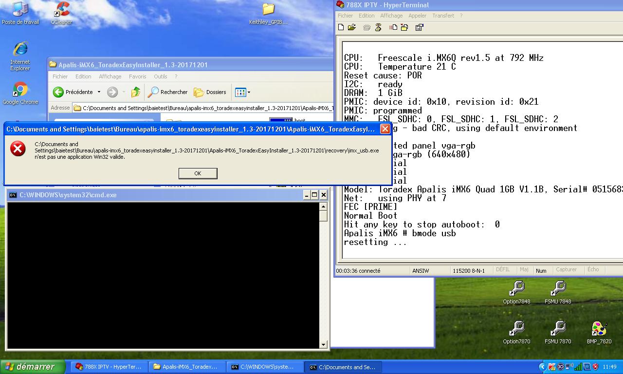

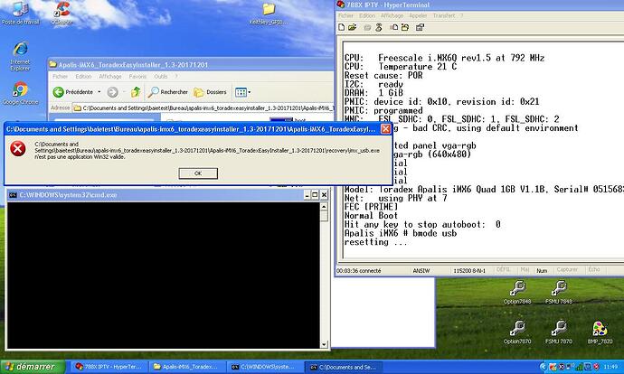

This is a screenshot showing the error message. I have the same problem at home with a VM running windows xp 32 bits.
Dear @fd101283
The imx_usb.exe
has a built-in marker that it requires at least Windows Vista to run.
There’s no obvious reason why this should be required. I patched the binary to accept Windows XP, too. You can download it through the link below:
Let me know whether this fixes the issue.
Regards, Andy

Hello Andy,
No the problem is not solve.
I’ve always the same error message. No change.
Are you sure you upload the right file ?
Hello Andy,
Same problem with same error message !
Dear @fd101283
As I wrote in my previous answer from 2018-06-12, I also found that my quick fix did not solve the problem. I’m afraid to tell you that we are not going to invest more resources to make it work under Windows XP.
