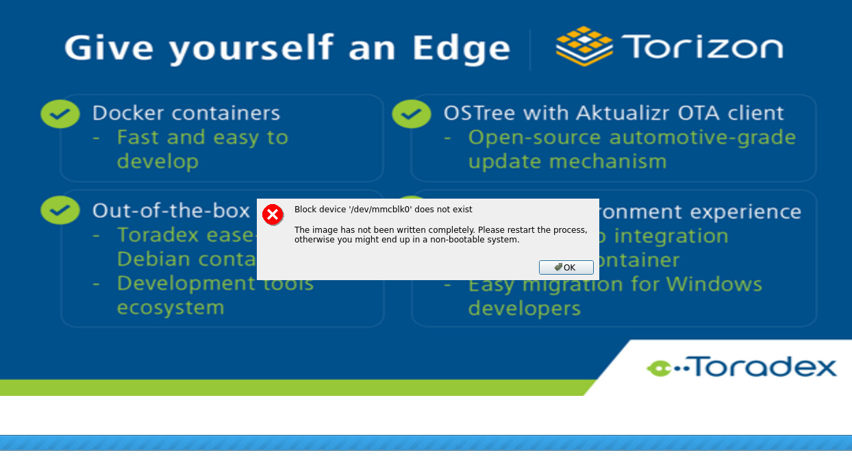

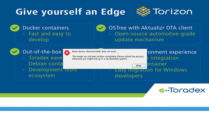

From your description, it sounds like when flashing your SoM with a custom Easy Installer image created by TorizonCore Builder, you are unexpectedly prompted for the device’s model and serial number, and you see an error message after selecting your image. Unfortunately, I can’t read the text in the attached screenshot, but I can guide you based on common scenarios and best practices.

Internal eMMC State
If you formatted or erased the eMMC, sometimes device info stored in U-Boot environment is lost. This can trigger prompts for device model and serial number. These should be entered accurately when prompted to ensure subsequent installations work correctly.
Try Official Reference Image
As a test, download an official reference image for your SoM from Toradex and flash it using Easy Installer. This helps verify if the issue is related to your custom image or a broader problem with the device: Toradex Easy Installer - Detailed Manual
Next Steps:
Please review the text contents of your image.json and ensure the product ID matches your SoM.
If possible, copy and paste the exact error message you see after selecting the image for further targeted assistance.
If the device info prompt appears, enter the correct model and serial number as indicated on your SoM label.
