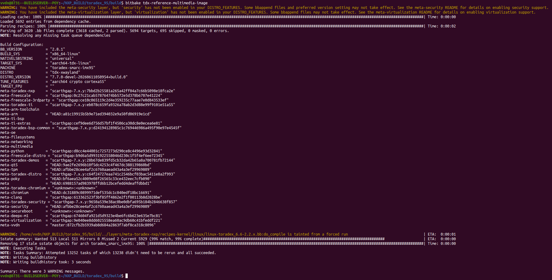

We are using the latest BSP only 7.7.0. We are using the SD card boot with this image, but nothing from the UART console. After that only we tried the EMMC flashing, for this we are facing this error LIBUSB_ERROR_NO_DEVICE. We are stucked in this. Could please help us to resolve this?
Please note that we do not support booting from an SD card. You may use it if you wish, but should you encounter any issues, you will need to resolve them on your own. We recommend using TEZI for module flashing. Please load TEZI v7.6.0 or higher and use it for flashing.
Sorry, I did not understand how the provided screenshot relates to the “LIBUSB_ERROR_NO_DEVICE” error. Please check the recovery-linux.README file included in the TEZI package and follow the instructions provided there.
Please do not post screenshots anymore if the information displayed can be collected as text. Instead, share the text as an attached .txt file.
