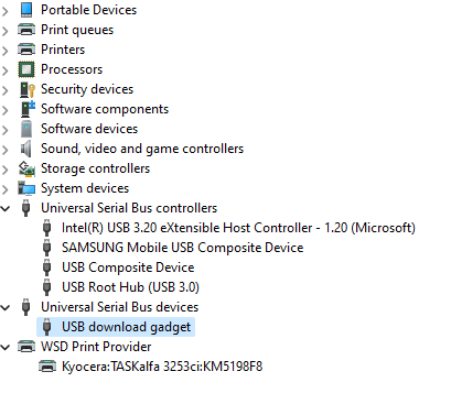

When trying to get the device to fastboot mode by “adb reboot bootloader” it seems like the device goes into fastboot mode and in Device manager I could see “USB Download Gadget” however fastboot devices cannot detect any devices.

Even though after selecting ADB device and selecting yes in the popup, it doesn’t seem to change.
What do you mean with “it doesn’t seem to change”? Do you still see it as a “USB Download Gadget” despite selecting ADB device? Can you post a screenshot of how the device appears in your “Device Manager”?

Hi Diegor,
Yes, exactly. I still see it as “USB Download Gadget” despite selecting ADB device.

in that case, the issue is for sure that the driver change didn’t occur.
The “Adb device” is not signed, so you need to make sure driver verification is not enforced:
