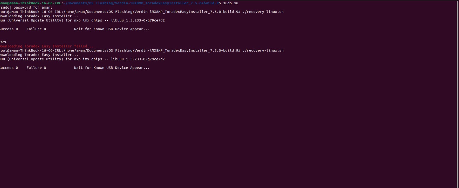

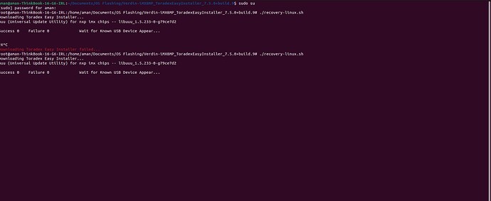

But I need the troubleshoot issue need for the linux host after followed the specific recovery mode and tezi installer download form the docs for the verdin imx8mp, nothing troublehsoot issue is given by the tdx docs for the linux, im still pending for the command response for both “./recovery-linux.sh” and “sudo sh recovery-linux.sh”

By default the Ivy carrier doest have the uart console and multiple OTG Support port only single usb otg port verdin ivy carrier board v1.0A, only the way is I have the linux host machine tezi installer failure while the recovery command is executed as both “sudo sh recovery-linux.sh” and “./recovery-linux.sh” are failed and only error is occured. need the trouble shoot issue clearance like the docs already have only for the windows machine.
