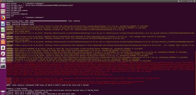

Tezi build error
I follow “High performance, low power Embedded Computing Systems | Toradex Developer Center” to setup my yocto environment and get tezi from “GitHub - toradex/meta-toradex-tezi: Meta layer to build Toradex Easy Installer images”.
But when I build tezi there is error appear.
Loading cache: 100% |############################################| Time: 0:00:00 Loaded 2669 entries from dependency cache. WARNING: No recipes available for:   /home/lucas/oe-core/build/../layers/meta-toradex-tezi/recipes-kernel/linux/linux-toradex-mainline_4.14.bbappend NOTE: Resolving any missing task queue dependencies
Build Configuration: BB_VERSION
= "1.32.0" BUILD_SYS         = "x86_64-linux" NATIVELSBSTRING   = "Ubuntu-16.04" TARGET_SYS        = "arm-oe-linux-gnueabi" MACHINE
= "colibri-imx7" DISTRO            = "tezi" DISTRO_VERSION    = "2.2" TUNE_FEATURES     = "arm armv7ve vfp thumb neon       callconvention-hard   cortexa7" TARGET_FPU        = "hard" meta-linaro-toolchain  meta            meta-oe            meta-python       = ":" meta-toradex-tezi = "morty-next:3531bbacc815a8a4d31f08b4c345726e8cc3afe3" meta-toradex-tegra  meta-toradex-nxp   meta-toradex-bsp-common  meta-freescale     meta-freescale-3rdparty  meta-qt4      meta              = ":"
Initialising tasks: 100% |#######################################| Time: 0:00:03 NOTE: Executing SetScene Tasks NOTE: Executing RunQueue Tasks WARNING: qt4-embedded-4.8.7-r0 do_fetch: Failed to fetch URL http://download.qt-project.org/official_releases/qt/4.8/4.8.7/qt-everywhere-opensource-src-4.8.7.tar.gz, attempting MIRRORS if available WARNING: libconfig-1.5-r0 do_fetch: Failed to fetch URL http://www.hyperrealm.com/libconfig/libconfig-1.5.tar.gz, attempting MIRRORS if available WARNING: qt-tezi-1.7-r0 do_fetch: Failed to fetch URL git://eng-git.toradex.int/cgit/qt-tezi.git;branch=master;protocol=http, attempting MIRRORS if available ERROR: qt-tezi-1.7-r0 do_fetch: Fetcher failure: Fetch command export DBUS_SESSION_BUS_ADDRESS="unix:abstract=/tmp/dbus-rFsEtznxP2"; export SSH_AUTH_SOCK="/run/user/1000/keyring/ssh"; export PATH="/home/lucas/oe-core/layers/openembedded-core/scripts:/home/lucas/oe-core/build/tmp-glibc/sysroots/x86_64-linux/usr/bin/arm-oe-linux-gnueabi:/home/lucas/oe-core/build/tmp-glibc/sysroots/colibri-imx7/usr/bin/crossscripts:/home/lucas/oe-core/build/tmp-glibc/sysroots/x86_64-linux/usr/sbin:/home/lucas/oe-core/build/tmp-glibc/sysroots/x86_64-linux/usr/bin:/home/lucas/oe-core/build/tmp-glibc/sysroots/x86_64-linux/sbin:/home/lucas/oe-core/build/tmp-glibc/sysroots/x86_64-linux/bin:/home/lucas/oe-core/layers/openembedded-core/scripts:/home/lucas/oe-core/layers/openembedded-core/bitbake/bin:/home/lucas/bin:/home/lucas/gcc-linaro/bin/:/home/lucas/bin:/home/lucas/.local/bin:/usr/local/sbin:/usr/local/bin:/usr/sbin:/usr/bin:/sbin:/bin:/usr/games:/usr/local/games:/snap/bin"; export HOME="/home/lucas"; LANG=C git
-c core.fsyncobjectfiles=0 clone --bare --mirror http://eng-git.toradex.int/cgit/qt-tezi.git /home/lucas/oe-core/build/downloads/git2/eng-git.toradex.int.cgit.qt-tezi.git
--progress failed with exit code 128, output: Cloning into bare repository '/home/lucas/oe-core/build/downloads/git2/eng-git.toradex.int.cgit.qt-tezi.git'... fatal: unable to access 'http://eng-git.toradex.int/cgit/qt-tezi.git/': Could not resolve host: eng-git.toradex.int
ERROR: qt-tezi-1.7-r0 do_fetch: Fetcher failure for URL: 'git://eng-git.toradex.int/cgit/qt-tezi.git;branch=master;protocol=http'. Unable to fetch URL from any source. ERROR: qt-tezi-1.7-r0 do_fetch: Function failed: base_do_fetch ERROR: Logfile of failure stored in: /home/lucas/oe-core/build/tmp-glibc/work/cortexa7hf-neon-oe-linux-gnueabi/qt-tezi/1.7-r0/temp/log.do_fetch.120428 ERROR: Task (/home/lucas/oe-core/build/../layers/meta-toradex-tezi/recipes-tezi/qt-tezi/qt-tezi_1.7.bb:do_fetch) failed with exit code '1' NOTE: Tasks Summary: Attempted 1598 tasks of which 390 didn't need to be rerun and 1 failed.
The compiler can’t find the server “http://eng-git.toradex.int/cgit/qt-tezi.git/”.
Is this server still alive? or is that address correct?

It’s strange, I still can’t access the server “http://eng-git.toradex.int/cgit/qt-tezi.git/”.
When I run “bitbake tezi-run” to build it, it always fail in same place.
Please note that the Toradex Easy Installer is not fully open-source. The server in question is a Toradex internal server and the qt-tezi project is closed-source proprietary.
