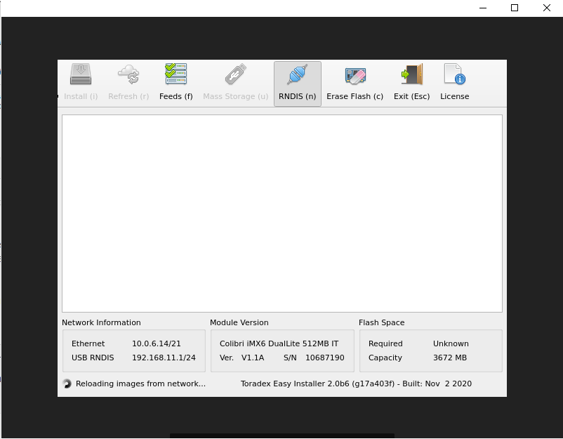

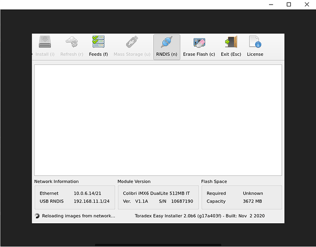

The issue occurs when the AVAHI service is already enabled on the image server before the module is booted into tezi.
When we connect to the module via VNC, screen shows an empty image list, the mouse cursor does move around the screen but it is a watch, the spinner at the bottom left next to ‘Reloading images from the network…’ is not moving, we are unable to interact with any of the buttons with the mouse or using keyboard shortcuts, and nothing further happens.
Below is a screenshot of the vnc connection.

tezi.log
/var/volatile # cat tezi.log
Failed to load client buffer integration: wayland-egl
USB Gadget: RNDIS enabled
Trying to read configblock from "mmcblk0boot0" at -512
Running Command:  "/usr/bin/avahi-set-host-name" ("colibri-imx6-10687190")
Finished with exit code: 0
avahi-set-host-name:
"AVAHI_CLIENT_S_REGISTERING"
Using the 'xdg-shell' shell integration
Scanning media initially...
Reading images from media "/dev/sda1"
Umounted external device /run/media/src
Network up in 0.106 seconds
RNDIS up in 0.19 seconds
Tezi Server lookup successfully
Downloading image list from  "http://tezi.toradex.com/image_list.json?PID8=00171100"
Downloading image list from  "http://tezi.toradex.com/image_list_3rdparty.json?PID8=00171100"
"AVAHI_CLIENT_S_RUNNING"
"AVAHI_BROWSER_CACHE_EXHAUSTED"
"New service 'Custom Toradex Easy Installer Feed' of type _tezi._tcp in domain local on protocol IPv6."
"New service 'Custom Toradex Easy Installer Feed' of type _tezi._tcp in domain local on protocol IPv4."
Adding zeroconf feed "Custom Toradex Easy Installer Feed"
Downloading image list from  "http://vulcan.local:80/tezi/image_list.json"
Emit abort...
When you have an AVAHI enabled and an image set up for autoinstall, will begin to install such an image automatically. You will not see an image list in that case. Could you check a TEZI log located at /var/volatile/tezi.log ?

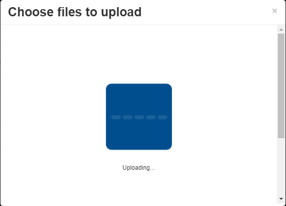

I haven’t been able to successfully attach a non-image file to a post.
I’m able to select the files and press upload. The upload progress text flashes at the top of the next screen, then it stays on the screen in the photo with the white bar filling animation.
I’ve tried disabling u-block origin, and ghostery extensions, and used Firefox, Edge, and Chrome from my desktop and Android with the same behavior. Do you have any alternate suggestions for attaching the files?
Your picture is not accessible. I did try to attach a file and looks like it works as expected attached file
Alex,
Uploading appears to be working for me now.

We found some race condition in Toradex Easy Installer when a auto install starts, it emits abort signal to stop all image downloading/polling, but apparently avahi image downloader itself not get stopped and keep trying install new images, the ends up into a loop. The R&D team is working on fix. However priority is not very high. We will update this ticket as soon as fix will be available.
