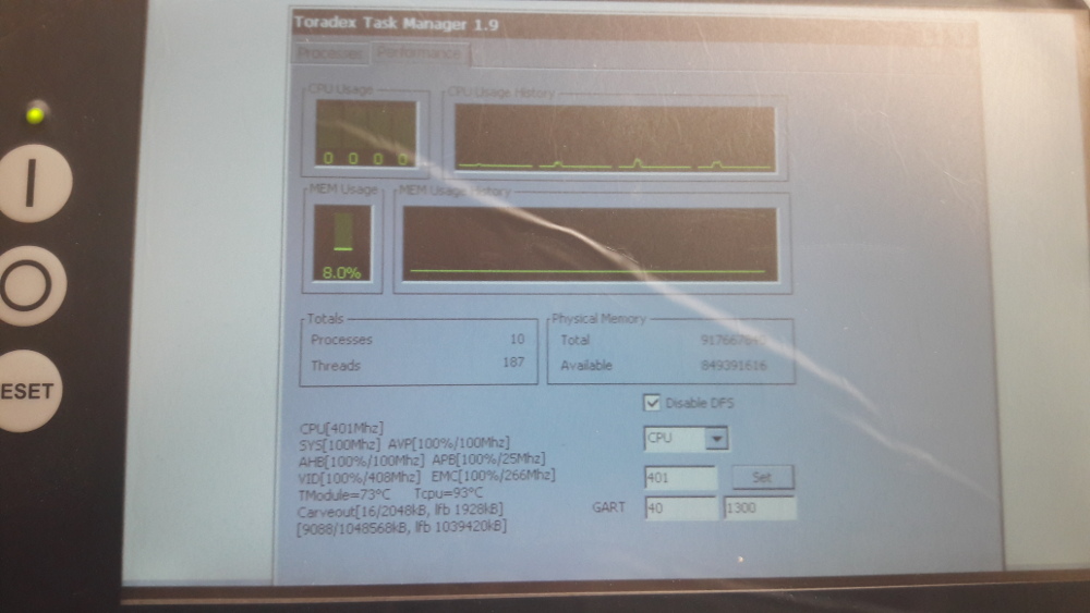

HI,
I tried disable the DFS and fix the CPU frequency at 400 MHz, but the module eventually runs to hot.
The other values (EMC, AHB, SYS etc) are set to 100% when DFS is disabled. I guess that’s way the module runs to hot. I also tried dismantling the housing so the module got some free air. Stills runs to hot with DFS disabled.
And it seems I cant fix the other frequencies for AVP, EMC etc with the task manager…
So I cant test it with DFS disabled…
PS: Tried on a free on desk Iris Carrier board. Stills runs hot and reboots

Do you have any kind of a fan? This helps quite a lot normally. Just send us the datasheet on our email support channel.
Maybe a Fan works. But that would be difficult to do with unit in production.
They have to remove the housing and install some ventilator during the calibration and testing during production.
I will try to see if we can do that with some of the unit when produced.
But if that gives us enough units to conclude anything from I don’t now. Maybe we just where lucky.
Thomas
Of cours that is not a final solution but only to test if we can eliminate the issue by switching off the DFS. I expect the display may still fails but the system should not crash any longer.
