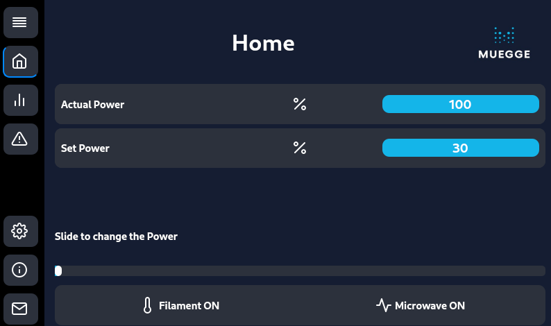

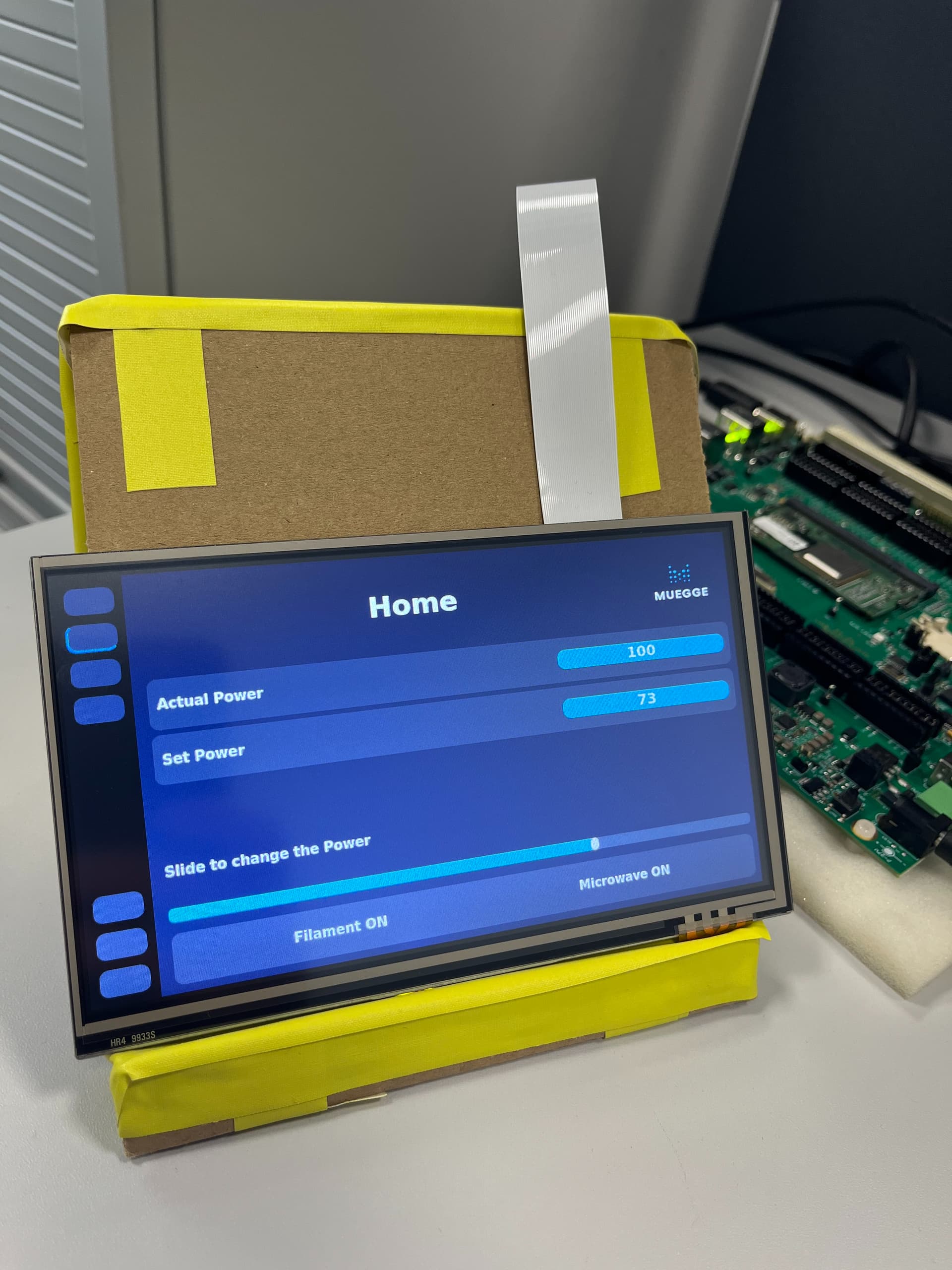

Our company is using the Colibri imx8 with the Colibri evaluation board to develop a new interface for our displays. I am using VSCode (Torizon Extension) and I have already designed a test GUI which I have successfully transferred to the collibri board. But I have some problems with the button icons. When I run the local Python script I can see the icons (see Localpython.png), but on the display the icons are not shown (see Displayimage.png). Also, the size of the buttons is smaller (the display resolution is set to 800x480). I tried to import PySide2.QtSvg but this lib is not recognised by the board. Do you have any idea how I can solve this problem? Can you also tell me if PySide6 will be available on Torizon soon?

That was my first thought too. So I tried to change an icon to another image. As you can see at the top right corner is an image (our company logo) so this image can be displayed. I then tried to change a random icon (menu or home) to a random image that was in the same path as the company logo. I could not solve it, it happened the same thing. It worked in my local machine but not in Display. That is why I do not think that there is a problem with the path.

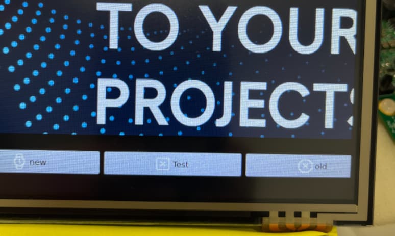

I was able to find a solution to this. As I suspected there was a problem with opening svg images. I made a simple gui and added png files as icons and it worked on display.

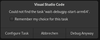

Could not find the task ‘wait-debugpy-start-arm64’
However, I could fix it. Here is what I did:
Removed any running containers and images on the target. You can do so from VSCode by right-clicking the running containers and images and selecting the remove option.
Then I removed the connected device first by selecting the Remove Default option and then the Remove Device option. Then add the network device again, set it as default. Run and Debug again by pressing F5. In this case, it solved the issue for me and I could successfully build and deploy my Pyside application.
