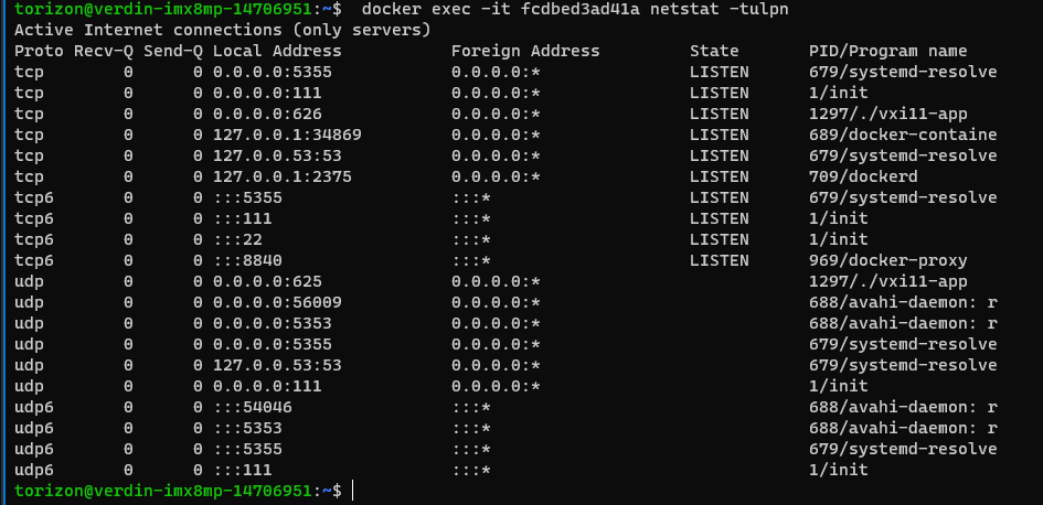

Hi @jeremias.tx , VXI11 is working with RPC. The issue arises with RPC port mapping (PORT 111 on both TCP and UDP). Since the same port(111) is used for RPC binding.
Hi @martgin @kkabh
I was able to verify that port 111 is in use on both TC5 and TC6 by both systemd and rpcbind in the host OS:
root@verdin-imx8mm-06827809:~# fuser -v 111/udp
                     USER        PID ACCESS COMMAND
111/udp:             root          1 F.... systemd
                     rpc         565 F.... rpcbind
I’m not sure this is specifically related to TCP/UDP ports.
You seem to be relying on X11 and QT. Do you have the other containers up and running? Are there any container logs you can share?
Drew

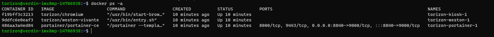

Hi @drew.tx ,
No other container is running.
MicrosoftTeams-image (1)
After running the vxi-11 application (inside container) on the old version(2022) .

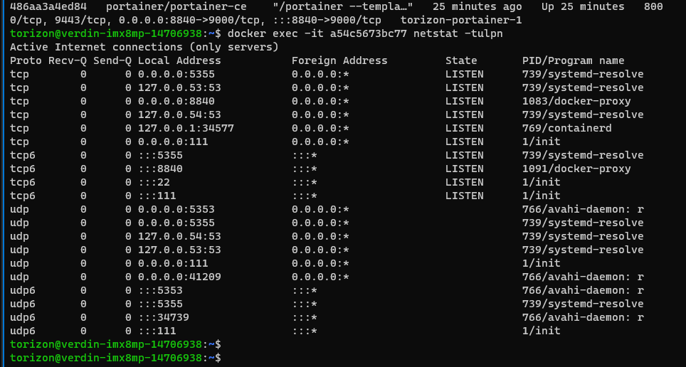

For the newer version(2023)

Hi @martgin
Can you run the “fuser” command under sudo on both tc5 and tc6? I don’t expect yours to look any different than mine but just want to confirm.
Is this a project you can share with me so I can try and run it locally?
