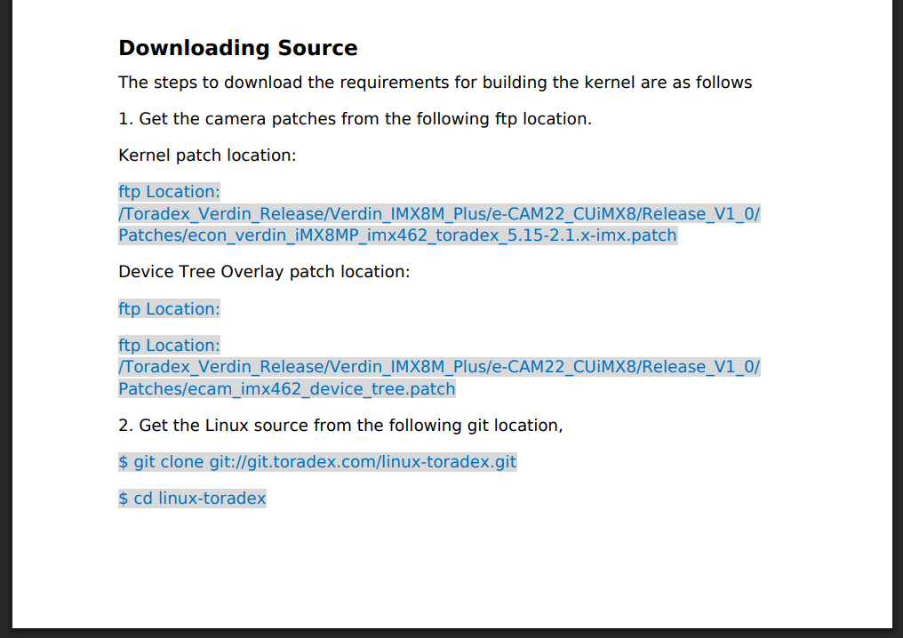

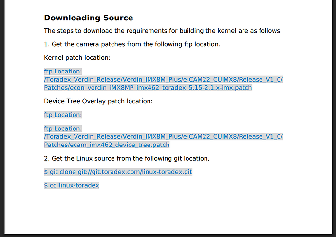

Thanks Sahil, we are currently using the sensors from our existing CCTV products, can you just help with sharing the related documentation?
Also, can you assist with exactly which git version that will be required for imx462 Integration??
-linux-toradex.git - Linux kernel for Apalis, Colibri and Verdin modules
Hi @girish07,
Usually, the camera related documents should be provided by the camera vendor.
I suggested you to please login/create account at e-con and download the documentations.
Their documentation contains patches, device tree settings, driver and the procedure for integration for Verdin iMX8.
I can see kernel version 5.15 is used.
Please download the documentation and take reference from there.

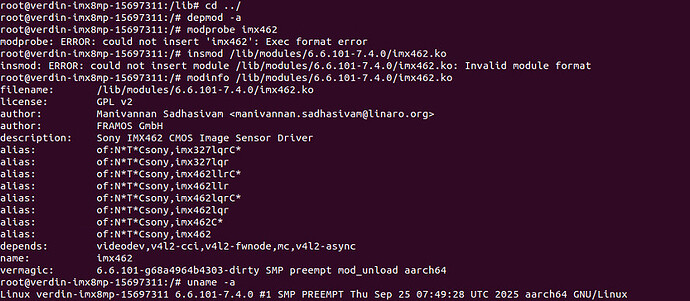

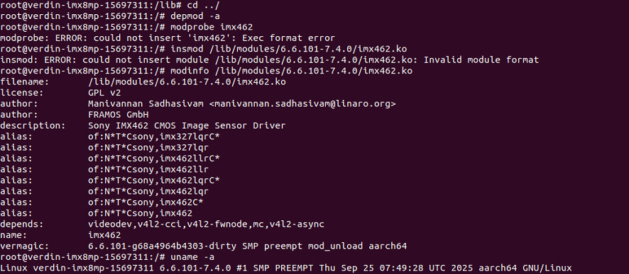

Hi @sahil.tx , I have downloaded the docs provided in econ, but since it is using different kernel patch, it is not supported with the board, I’m using (Toradex -v: 6.6.101‑7.4.0) can you provide support for this specific version??
