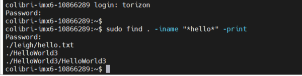

$ sudo find . -iname "myfile.txt" -type f
`password: [used same as my user password, which I changed to torizon1 ]

So, in that case it looks like sudo works as expected

colibri-imx6-10866289:/$ sudo -i
it asks for a password
if i type torizon1 it lets me into root:
root@colibri-imx6-10866289:~#
