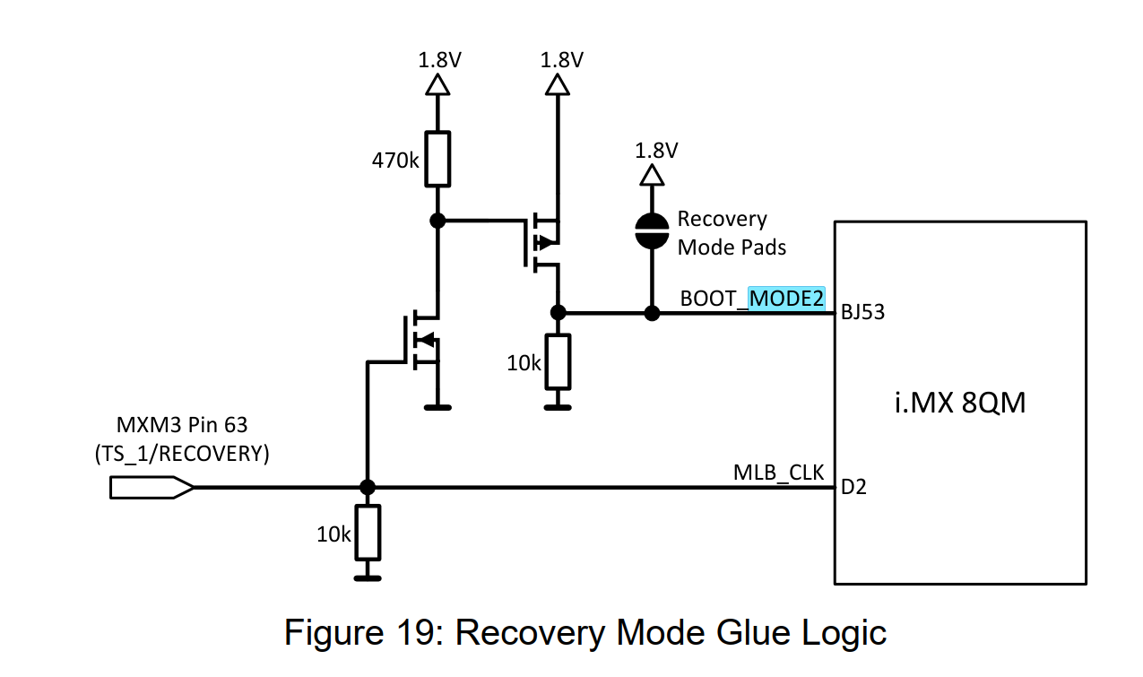

What is the mechanism of the recovery pins, is that going to bootctl GPIOs that boot into imx serial download mode? Is there a GPIO I can read from u-boot to see if that’s been shorted somehow?
Yes.
I’m not sure whether that magic system control unit firmware might interfere with that, to be honest but anyway, you are supposed to first answer all my questions before I answer any new ones from you…

I found this topic because I’m having the same issue as Aaron did. I had a working Apalis iMX8QM and used the recovery update / TEZI installer multipe times on it. The last time I used recovery/TEZI it didn’t boot anymore (not even u-boot). Then I discovered that I could still use the USB recovery boot, but now without any recovery pins shorted. So for some reason it seems stuck there.
I followed your u-boot commands above, but what does this tell?:
Apalis iMX8 TEZI # fuse sense 0 18
Sensing bank 0:
Word 0x00000012: 00000008
Apalis iMX8 TEZI # fuse sense 0 19
Sensing bank 0:
Word 0x00000013: 00000027
Apalis iMX8 TEZI # mmc bootbus 0 2 0 2
Apalis iMX8 TEZI # mmc partconf 0 1 1 0
Apalis iMX8 TEZI # fuse read 0 276
Reading bank 0:
Word 0x00000114: 000000bc
Apalis iMX8 TEZI # fuse read 0 277
Reading bank 0:
Word 0x00000115: 000044f3

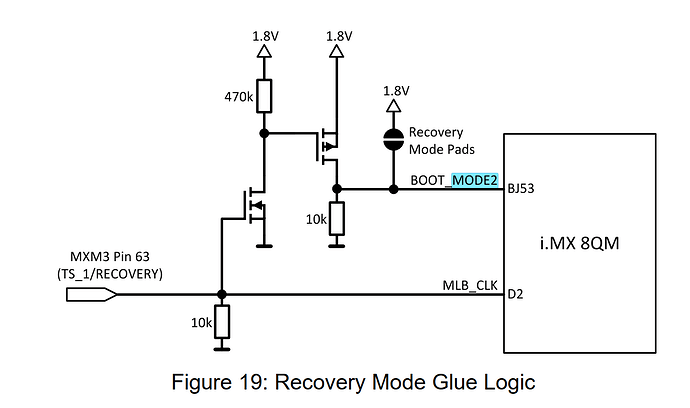

EDIT: I measured both sides of the recovery mode pads on the module, and they both are at 1.8V. So it seems that one of the FETs controlled by TS_1/RECOVERY is blown :frowning:
