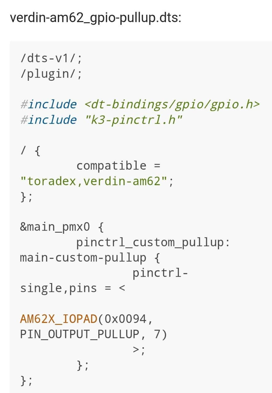

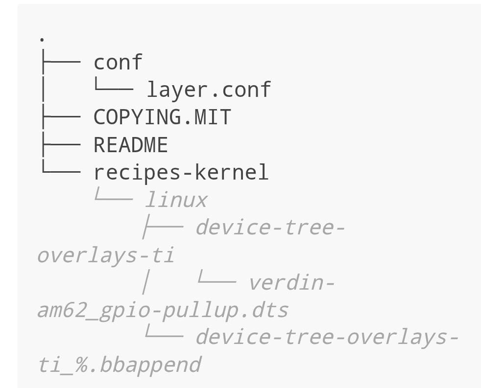

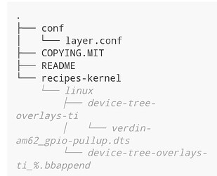

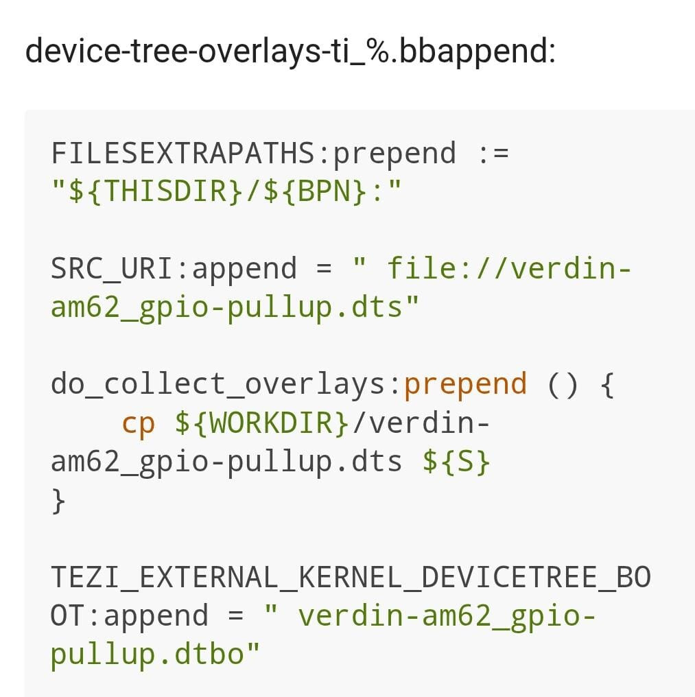

Hi @leonardo.costa.tx @ToradexAI
its quite confusing like i built overlays for adxl345 and also for dual channel lvds and gpio aswell few days like i followed this steps
file structure
dts file
recipe file
so with this i use to build and this will directly add that dtbo file fdt_overlays (TEZI_EXTERNAL_KERNEL_DEVICETREE_BOOT:append
are you referring to the same structure or what little confused between those
with one example can you please provide completely all the steps with code from creating device-tree to applying that to u-boot
Uday
