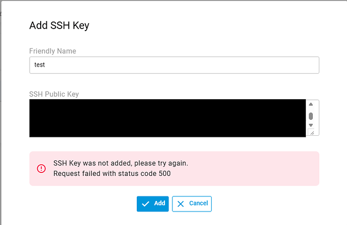

Attempting to add any SSH key to Torizon Cloud’s remote access portal returns this error:
SSH Key was not added, please try again.
Request failed with status code 500
I’ve attempted to add keys from multiple separate machines (Windows and Ubuntu) and multiple browsers (Firefox, Chrome, and Edge) with the same result.
Any advice on why this might be happening would be greatly appreciated.

Hi @srwillie
It seems you marked the AI message as a solution. That’s great. Can you elaborate what specifically fixed it for you?
Drew
This was the section that helped me:
The exact formatting in the quoted text didn’t work, but it convinced me to paste the entire contents of the generated SSH key file rather than just the key string.
Pasting in just,
<ssh-key>
returns the 500 error.
However, with the full file contents,
ssh-rsa <ssh-key>=user@domain
it works.
