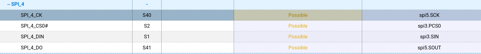

Hi, we would like to use a non-standard SPI on the SMARC IMX95. Now we did configure the SMARC SPI_4 on the Pinout Designer. The configuration uses SPI5 and SPI3 function. Is this possible?

Pinout Designer Configuration
The Pinout Designer is designed to validate pin multiplexing configurations and detect conflicts(1). When you configure SPI_4 using both SPI5 and SPI3 functions, the tool should indicate if there are any resource conflicts in the “Conflicts” column(1).

The Pinout Designer should show you any conflicts in real-time - if it’s not showing conflicts, the configuration should be technically feasible from a hardware perspective(1).
