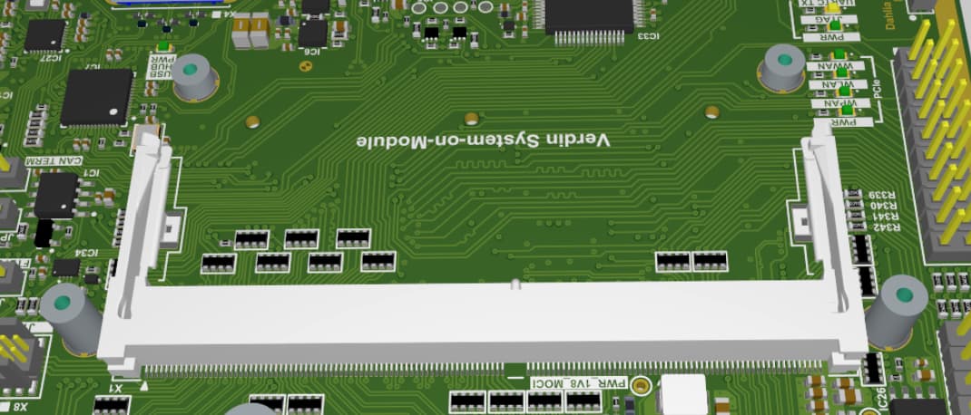

The selected verdin SOM module is VERDIN MA62DUAL 1 GB IT, part number 00741102 & PN for the Heatsink is 23111001 for this whether standoff will be provided by Toradex or not?
The standoffs are already located on the carrier board and not included in the heatsink package.
The Verdin Heatsink (23111001) package includes one heatsink and four M2-sized screws.
