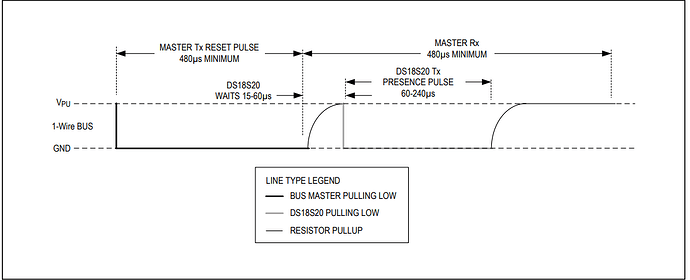

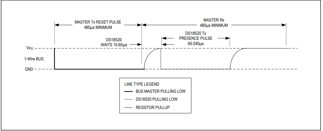

Particularly i want to control temperature sensor DS18S20, but i cant get it to do the “initialization procedure”, which consists in sending a pulse to the sensor and then receive the “acknowledge” signal from it.

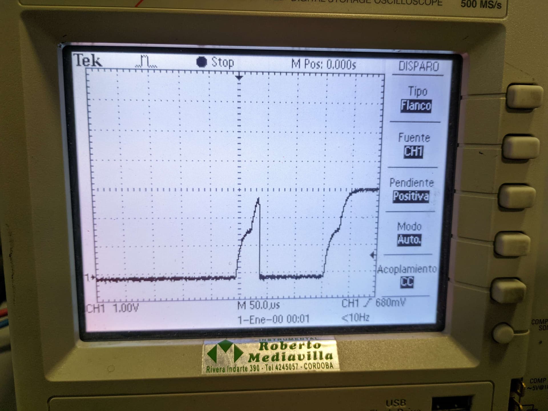

I sensed the pin with an oscilloscope and definetly the sensor works fine, therefore i’m able to see the low signal, but in my C program the logic level never changes.
This low signal lasts for about 50 us, but once i set the pin config to “in” im not able to detect any change.

To capture that pulse, you need to use a GPIO interrupt. Please check the following threads:
In Linux, especially on 6ULL, everything shorter than 10ms is hard real time. Shorter than 2ms is extreme real time. Are you kidding catching 50us pulse in bash script? I didn’t time sleep 0 call, but I guess it is longer than 50us when lucky to hit I-cache.
Perhaps you could solve it with C and libgpiod, but even for C it is challenging and not guaranteed due to Linux nature. Use external MCU or perhaps upgrade to iMX7 with real time M4 code on the same chip.
