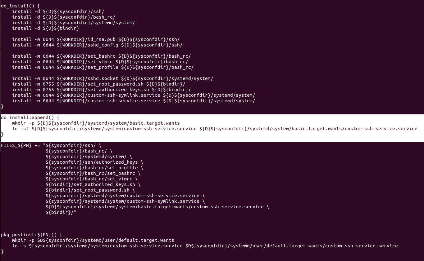

We have a system that we are building on an Apalis imx8 board. We use a custom imagebase on the “tdx-reference-minimal-image” and we TFTP Boot the board with that image, which works perfectly. This image has a service that we created using a custom layer/custom recipe, this service has the followings:
→ A script Set the password for user “root” : “set_root_password.sh”
→ other files to Configure ssh with id_rsa.pub key to be able to remote login to the board.
→ A service to run on startup one time {After=getty.target}, this service is the entry point to start the set_root_password.
Note that set_root_password.sh set all other need configuration such as network configuration.
The problem is the service doesnt run on startup. It only works if i manually run it using: systemctl start custom-ssh-service.
Here is how the config.bb and the custom-ssh-service:

do_install() {
install -d ${D}${sysconfdir}/ssh/
install -d ${D}${sysconfdir}/systemd/system/
install -d ${D}${bindir}
install -m 0644 ${WORKDIR}/id_rsa.pub ${D}${sysconfdir}/ssh/
install -m 0644 ${WORKDIR}/sshd_config ${D}${sysconfdir}/ssh/
install -m 0644 ${WORKDIR}/sshd.socket ${D}${sysconfdir}/systemd/system/
install -m 0755 ${WORKDIR}/set_root_password.sh ${D}${bindir}/
install -m 0755 ${WORKDIR}/set_authorized_keys.sh ${D}${bindir}/
install -m 0644 ${WORKDIR}/custom-ssh-symlink.service ${D}${sysconfdir}/systemd/system/
install -m 0644 ${WORKDIR}/custom-ssh-service.service ${D}${sysconfdir}/systemd/system/
FILES_${PN} += “${sysconfdir}/ssh/
${sysconfdir}/ssh/authorized_keys
${bindir}/set_authorized_keys.sh
${bindir}/set_root_password.sh
${sysconfdir}/systemd/system/custom-ssh-service.service
${sysconfdir}/systemd/system/custom-ssh-symlink.service
${bindir}/”
pkg_postinst:${PN}() {
mkdir -p $D${sysconfdir}/systemd/user/default.target.wants
ln -s ${sysconfdir}/systemd/system/custom-ssh-service.service $D${sysconfdir}/systemd/user/default.target.wants/custom-ssh-service.service
