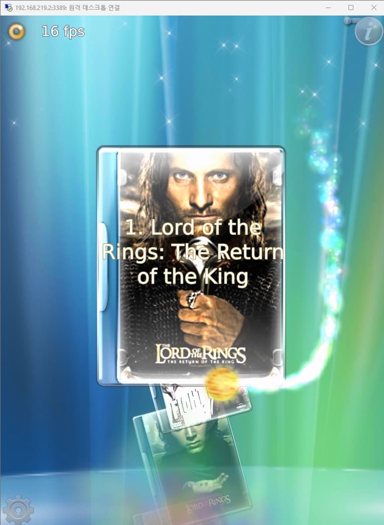

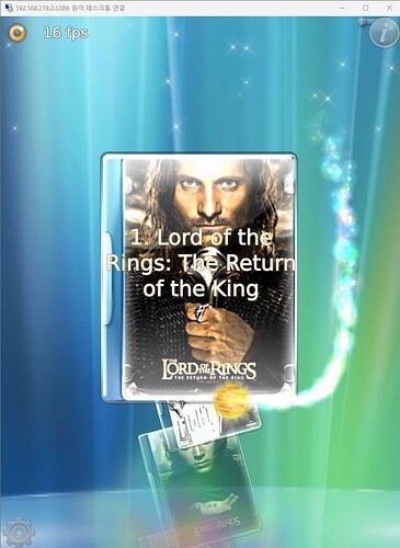

If I add modules=screen-share.so to /etc/xdg/weston/weton.ini, the 3389 port is bind, but the screen frame drops.

Remote access will slow down the application as stated here.
Enabling VNC or RDP on Weston will significantly slow down your application, even when the remote session is inactive. Additionally, due to security reasons, it is not recommended to enable VNC or RDP in production.
60fps performance is only supported on native display e.g. HDMI, LVDS display.
