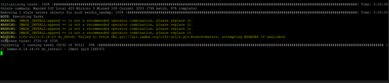

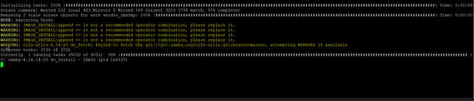

While building an image I got a WANRNING like below
cifs-utils-6.14.-r0 do_fetch: Failed to fetch URL git://git.samba.org/cifs-utils.git;branch=master, attempting MIRRORS if available**(Please see the below image )**
This is fine if you are able to build the package, the source code can be downloaded from available mirror link.

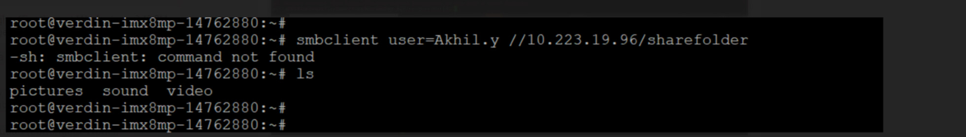

I’ve Entered command to connect the client => smbclient --user= /// got below error
Please share complete local.conf file to check how you are adding package.
we need smbclient on the target. as I mentioned in my previous query , If I use smbclient --user=Akhil //10.223.34.12/sharefolder
Note: Akhil is my windows username
10.223.34.12 is my windows IP addr
sharefolder is the foldername which I’m accessing from the target with the help of smbclient.
but it is showing smbclient: command not found.
how to get the smbclient to the target ?
