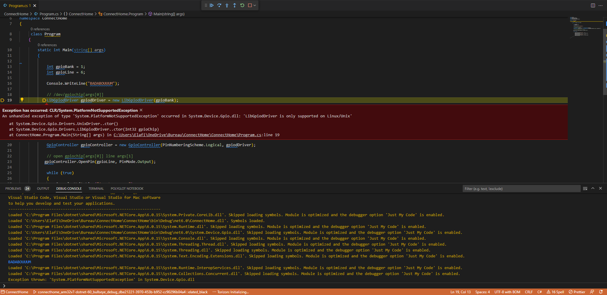

‘LibGpiodDriver is only supported on Linux/Unix’.
This error is strange since the code runs in a Linux container so it shouldn’t matter here. Did you get this error when attempting to debug and deploy? Did it specifically happen during the building stage?

Concerning the run/debug under windows, I always have the same error
libgpiod driver is only supported on linux/unix

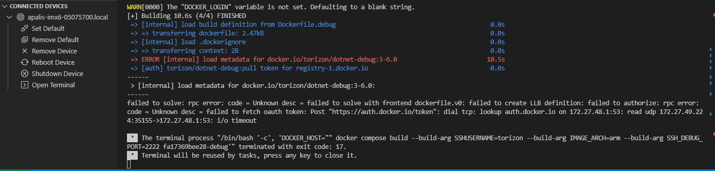

But now I have this error :
WARN[0000] The "DOCKER_LOGIN" variable is not set. Defaulting to a blank string.
Get "http://localhost:5002/v2/": dial tcp [::1]:5002: connect: connection refused
Can you share some lines before the WARN message? In particular the last line that starts with Executing task: is crucial to see which task ApolloX was trying to run before failing.

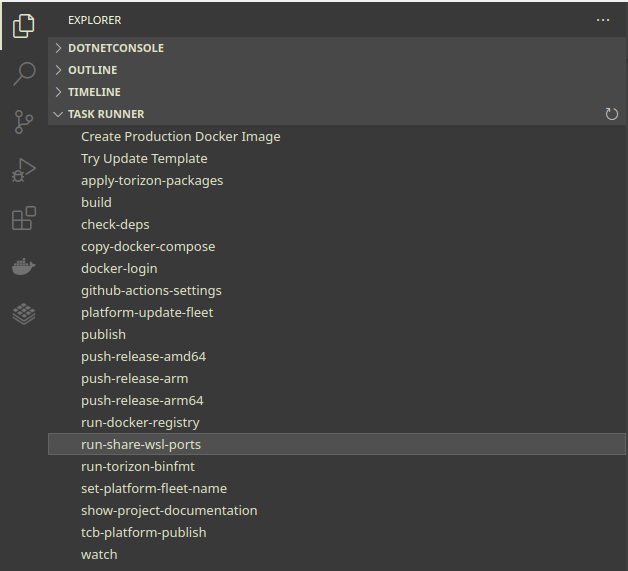

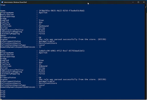

You’re using Windows, right? Just to be sure, can you run task run-share-wsl-ports and click yes when prompted? You can run the task by clicking on it in the task runner, as shown in the image below:

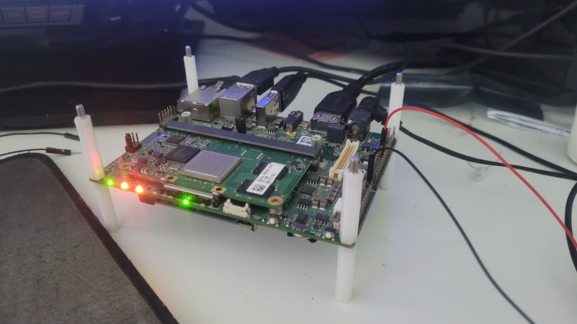

My setup =
-Ixora v1.1A,
-Apalis IMX6Q 2GB IT v1.1B
-Power = 12V (JP1 OFF)
-Mouse/keyboard USB
-Ethernet

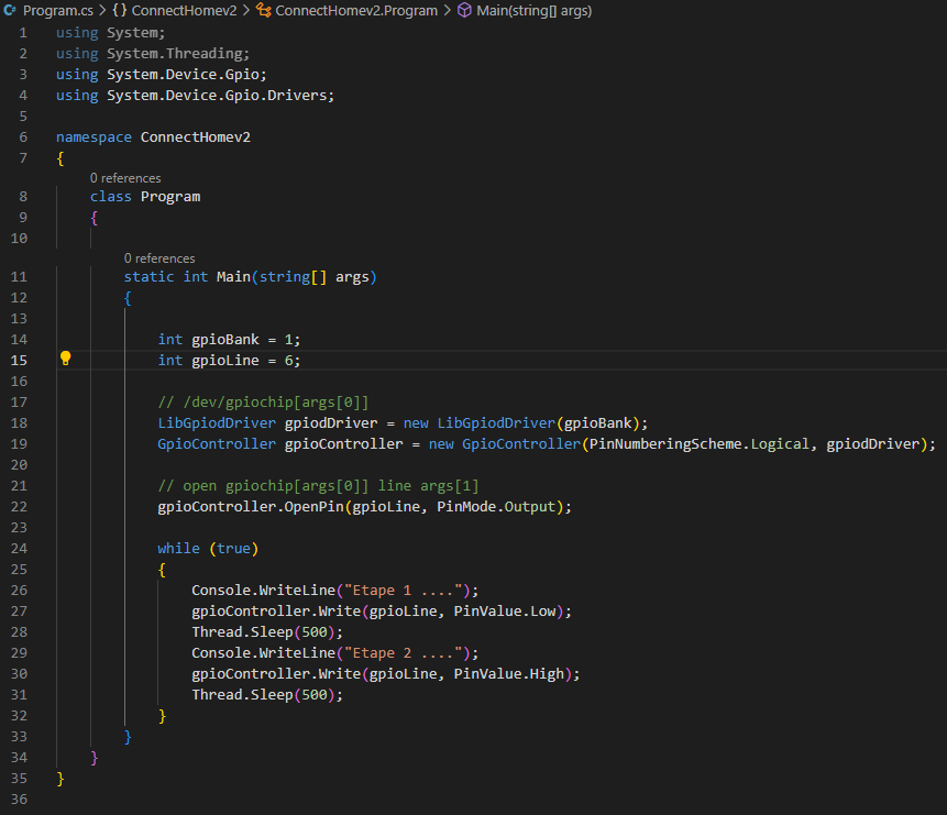

Here my program.cs :

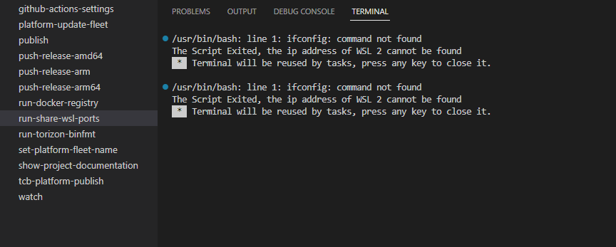

Here the result for ‘run-share-wsl-port’
Here the result of my run/debug Torizon V7 :

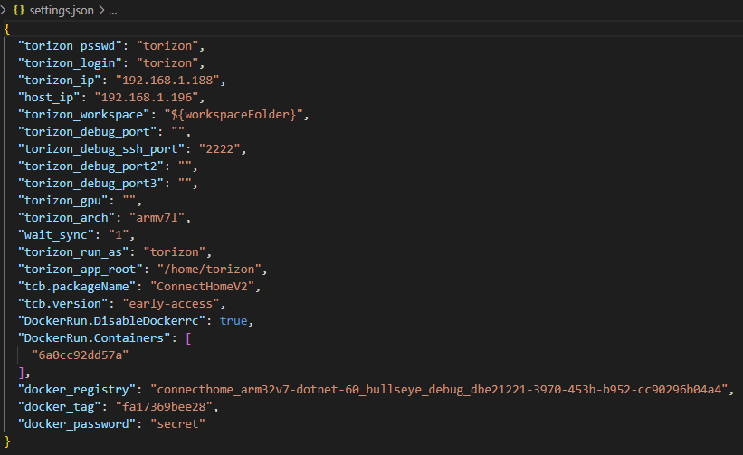

Here my setting.json :

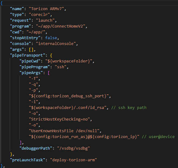

Here the “Torizon ARMv7” form my launch.json :
Concerning the windows side, here is the result of the run/debug output :
Edit ‘run-share-wsl-port’
solved with : sudo apt-get update && sudo apt-get install net-tools

From this image I can see that V1 of the extension is trying to initialize, but failing to do so (see at the bottom: Torizon: Initializing...). This is probably the cause of the issue you’re having with V1 i.e. the LibGpiodDriver is only supported on Linux/Unix error.
I recommend always disabling one version when using the other.
One more thing to keep in mind is that ApolloX sets a variable in VSCode that makes V1 unable to initialize correctly. You need remove this line if you want to use V1.
