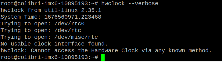

I’m developing an application in the imx6 SOM board. To display the date and time in the application UI, I’m trying to read the hardware time from RTC. I tried the default command as “hwclock -r”. While executing this, it shows error message as below.
Error: “hwclock: Cannot access the Hardware Clock via any known method.”
I tried to check the status of RTC by typing “hwclock --verbose”. This shows that, “No usable clock interface found”. I attached the screenshot for the error message for details. Kindly help to get the hardware clock in the application.

The output you are seeing from hwclock indicates that there is not rtc device in /dev. That can have two reasons:
  1. The driver for the hardware clock is not enabled in the Linux kernel configuration.in defconfig CONFIG_RTC_CLASS=y and the specific driver need to be enabled. There is an NXP built-in hardware clock for which it it is CONFIG_RTC_DRV_SNVS. The Verdin modules also have an external (more power efficient) hardware clock connected via I2C. For that the config is CONFIG_RTC_DRV_DS1307=y.
    1. The hardware clock device must be declared in the device tree and enabled. That is normally the case for the Toradex device trees.
