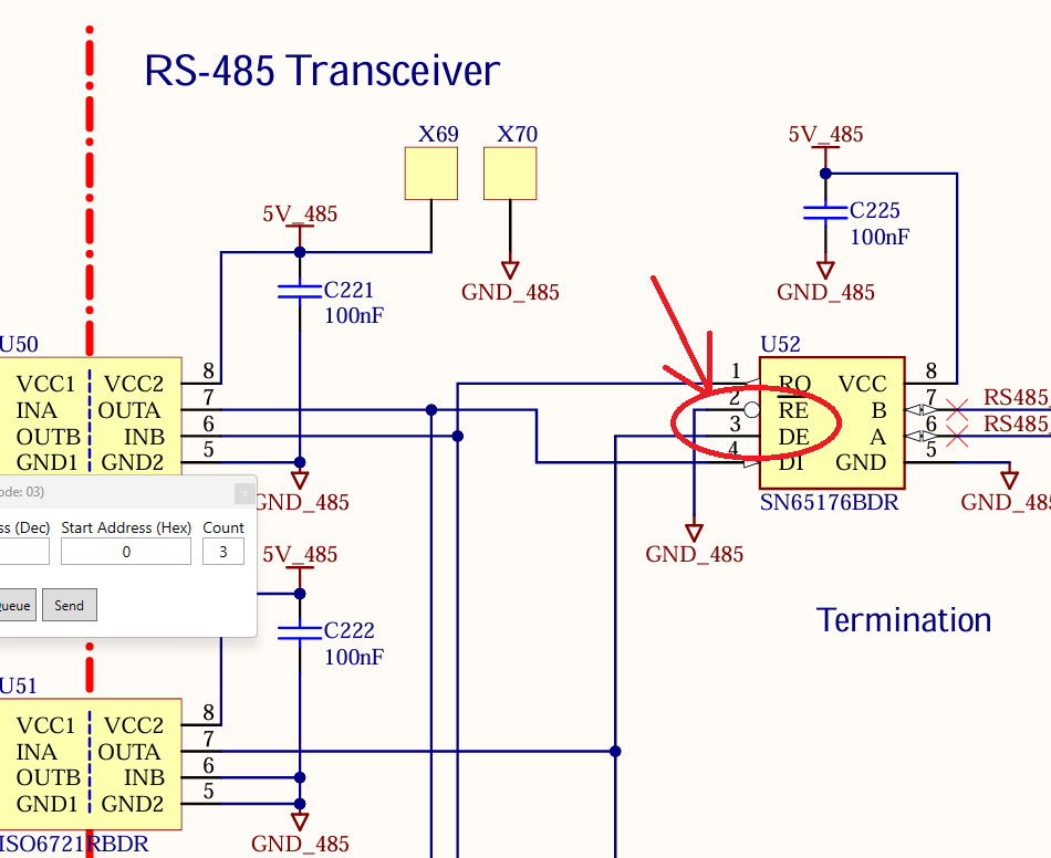

I am working on Modbus RTU using RS485 on a Ivy plus board ad Verdin AM62.
I have noticed that the Receive Enable of the RS485 transceiver is pulled to ground, which enables the receiver all the time. This means I will reviece the echo from my transmitted bytes as well.
This is unnecessary and worse, it now need to handle the echo bytes in my application and discard them, since they are not Modbus RTU protocol. After “receiving” the echo, I need to listen properly again, which makes the application more complex with no benefit at all.

My suggestion:
Please connect “Receive Enable” and “Driver Enable” pins together, with this the RTS signal will switch between send/receive properly and I won’t receive the echo.

Unfortunately, this is not helpful… Because it’s hard wired on the PCB…
Hi @sportmann!
Unfortunately, the RTS signal as send/receive control is not implemented in our Ivy Plus board.
However, you can bypass it using software. My suggestion is: since the “feedback” is instantaneous, you can discard it by comparing the message sent and the received; if they are equal, you ignore it.

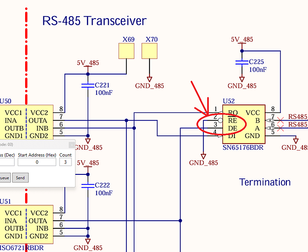

In fact, the RTS is implemented on your Ivy board. RTS drives the RS485 transceiver’s enable pin (DE). This is ok, but in my opinion not the best way to handle it.
I’ve posted this as a suggestion for further revisions of the Ivy board. Please review my suggestion with the hardware designer of the Ivy board.
