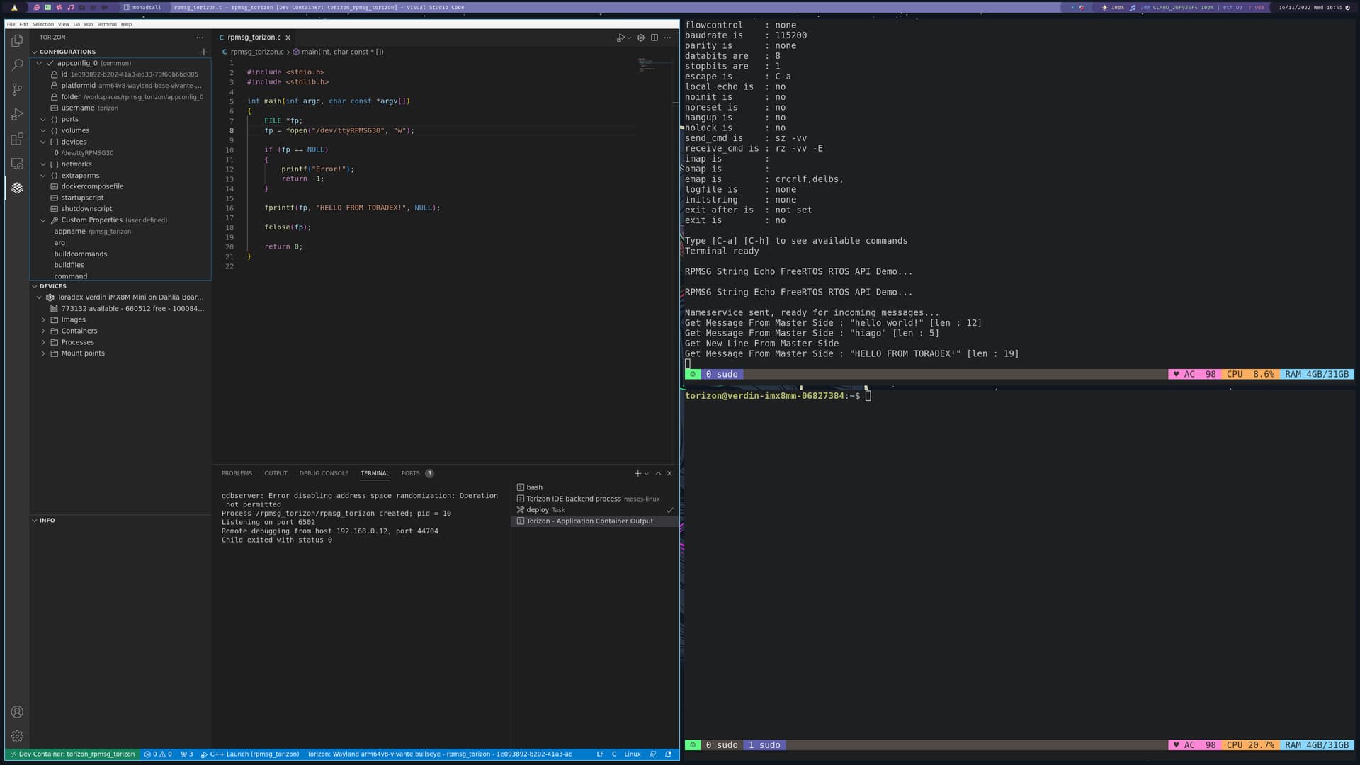

I made a quick test here:
I created a simple container running C and exposed the ttyRPMSG30 (you can see in the left image the “devices” configuration). Then I deployed pressing F5 and it worked.
