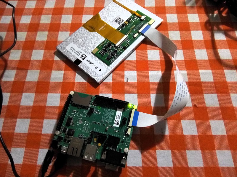

Could you share also the dmesg log ( dmesg > dmesg.txt ) in a text file and pictures of the connection of your touch screen?

Thanks for the file. Did you follow up the instructions on this site? As already asked, please share the picture of the connection between the touchscreen and the aster carrierboard?
Thanks for the Link, I did not see before the connection, I was connecting wrong the flat cable, I fix it and now the Touch Screen works! =). Could you give me an advice for configure resolution?, because I can’t stop U-Boot from Serial terminal or How can I configure the resolution? Many thanks for your support. If I try to put setenv command in the shell the shell say that the command not existe.
