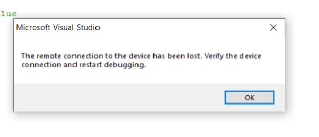

For our project, While debugging code gets error case like "Remote connection to the device has been lost, verify the device connections and restart the debugging "

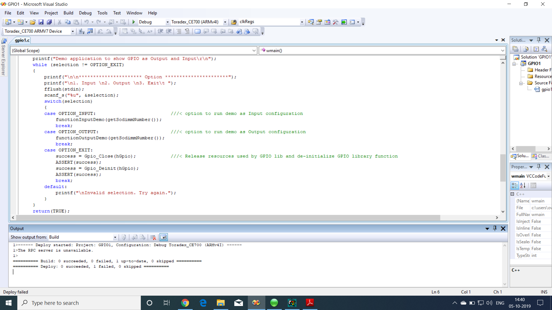

After sufficiently closed Visual Studio and restarted project debugging it gives error like RPC server is unavailable
for solving this error I refer , Suggest, how to resolve this error case?

Now sometimes getting same error case in Hello-world and GPIO projects as per below

Now, Hello-world and GPIO programs are debug successfully there is no RPS server error.

Okay, In my case Just restarted system and solve this RPC server is unavailable
for demo application like GPIO and Hello-world but for our another project it shows similar .
