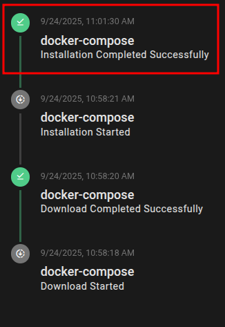

I have performed an application OTA update using a Dockerfile and initiated the update through the Torizon Cloud platform. After the update, I noticed that running commands like docker ps -a or docker images on the board showed nothing. However, after rebooting the board, the Docker image appeared and the application started running in the background. This raises my doubt: for an application OTA update, is a reboot required, or should it work without rebooting?

On the Torizon Cloud platform website, were you able to confirm that the update has been completed?
After you “initiated the update”, there are some steps before the update is completed.
  1. You initiate the update
  2. The remote board sees that there is an update available (polling)
  3. The container images are downloaded from the registry
  4. The container is instantiated
To test it, you can try:
  • Initiate the update from the website
  • Run this command on the board to see the logs.
journalctl -f -u "aktualizr*"
