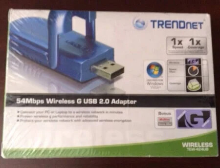

Just to add another alternative:
I use the Dahlia with that exact SoM with an USB-C Ethernet Adapter (albeit for other purposes) and it works quite well:
Bus 002 Device 002: ID 0bda:8153 Realtek Semiconductor Corp. RTL8153 Gigabit Ethernet Adapter
I haven’t tried it with your particular board, but that is the reason I always keep around at least one “Big Ugly Blue”
Of course you may need to keep an old router around to support them. These are so old that every Linux distro has the drivers baked in. Now that I’ve said that I will probably find distros so new they are purging the old drivers . . .
Nope, they aren’t fast. Nope, they don’t have huge range or signal strength. Having functioning wifi when the on-board RJ-45 stopped working . . . priceless.
Scrounge around in the second hand places.
