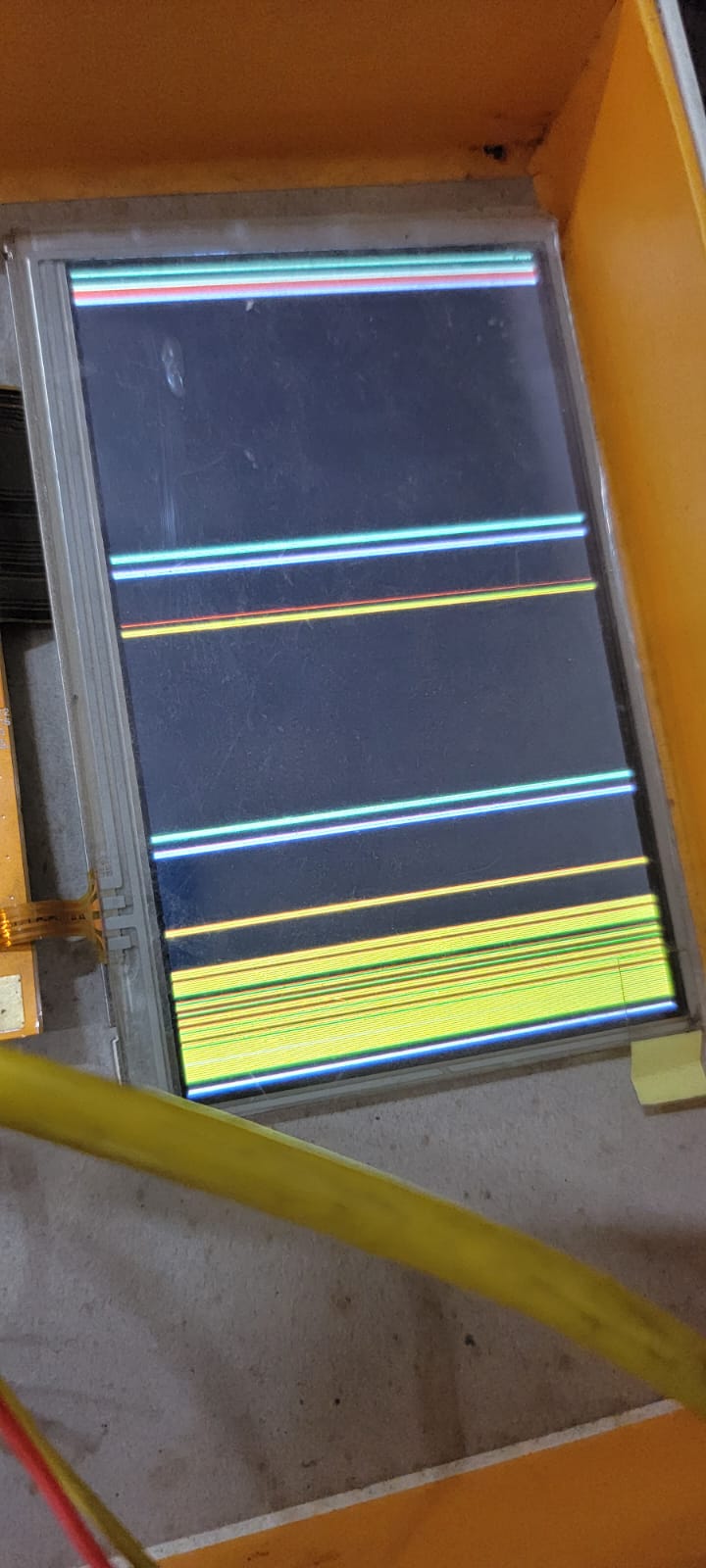

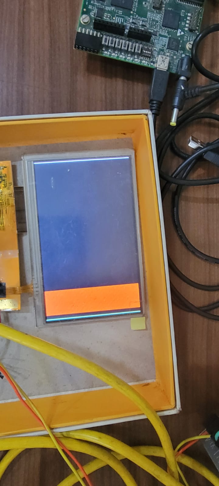

We are using Torizon 5.6.0 with debian container on Colibri iMX7.
When we reboot or shutdown the system, we observe random screens as seen in attached photos
How to get proper animation or screen. Please suggest.

  • From your screenshots this display doesn’t seem to be one of ours for the Colibri family, like the Resistive Touch Display or the Capacitive Touch Display - 7 inch. Can you confirm what display are you using?
    Display is not purchased from Toradex.
  • How are you connecting the display to the Colibri iMX7?
    We have one customized board where we connect the display. We mount Toradex Viola carrier board on it. There is one display ribbon cable that connects customized board to carrier board.
  • Are you using one of our Carrier Boards or a custom one?
    We are using Toradex Viola Carrier Board with Colibri iMX7 1GB SOM
  • Does the screen always appear like that or after the reboot sequence it works as intended?
    I have customized the torizoncore as per our requirement. I have changed the Splash screen.
    Only while rebooting or shut down, these screen patterns are being observed.
