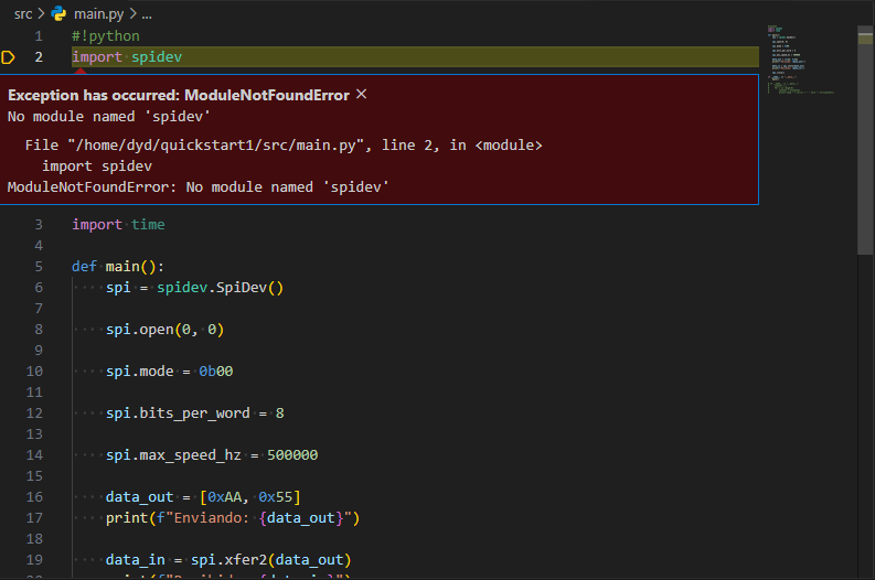

Even running # spidev_test -D /dev/verdin-spi-cs0, I can see data frames being sent on the oscilloscope. However, when I try to import spidev in Python or install it from the requirements.txt file, I get an error.

Yes, that’s the main problem.
When I try to run my python code I receive this error

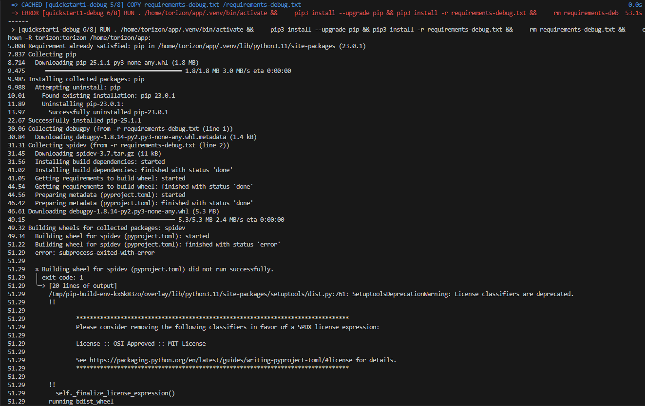

I tried to install spidev over the requirements-local, requirements-debug and requirements-release txt and in the Dockerfile using pip and apt-get.
When I debug and try to install over requeriments-release.txt I had this message

The issue you’re facing occurs because, by default, the container does not include the necessary cross-compilers. I was able to reproduce the issue here, and the key error message is:
15.41       aarch64-linux-gnu-gcc -Wsign-compare -DNDEBUG -g -fwrapv -O2 -Wall -g -fstack-protector-strong -Wformat -Werror=format-security -g -fwrapv -O2 -fPIC -I/home/torizon/app/.venv/include -I/usr/include/python3.11 -c spidev_module.c -o build/temp.linux-aarch64-cpython-311/spidev_module.o
15.41       error: command 'aarch64-linux-gnu-gcc' failed: No such file or directory
15.41       [end of output]
To resolve this, you’ll need to ensure that the cross-compilers and the required headers are available in the container. You can do this by updating your torizonPackages.json file as follows:
  "prodRuntimeDeps": [],
  "devRuntimeDeps": [
    "build-essential",
    "python3-dev"
Please try the solution above and let us know if it works or if you have any other doubts.
