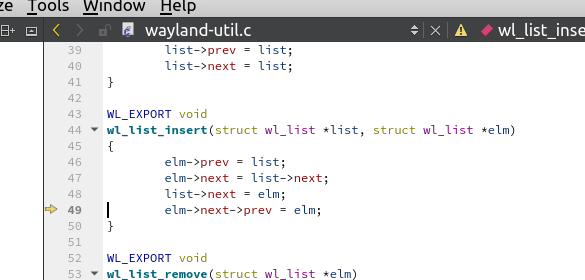

In debug mode of QtCreator, it stops at wl_list_insert
. But I don’t get more information after it.
A similar issue was reported on Qt Bug Tracker. You can report it as well.

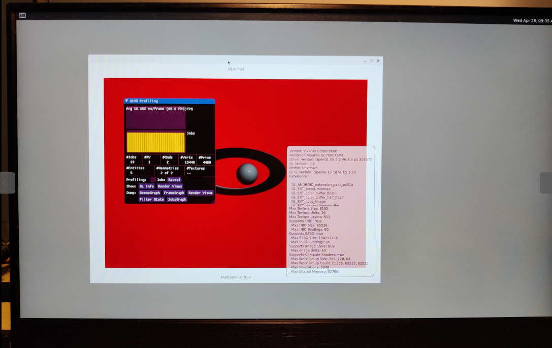

Hi @farshid616 , by upgrading Qt version to 5.15.2, scene3d works on Apalis iMX8.
Here is how I upgrade meta-qt5 layer.
cd layers
rm -rf meta-qt5
git clone https://github.com/meta-qt5/meta-qt5.git
cd meta-qt5
git checkout 280487f20bca829527a597d6263b0344a01917ac
Before rebuilding multimedia image, you also need to clean up the cache, for example, delete sstate-cache, build/tmp, build/deploy, build/cache
etc.
